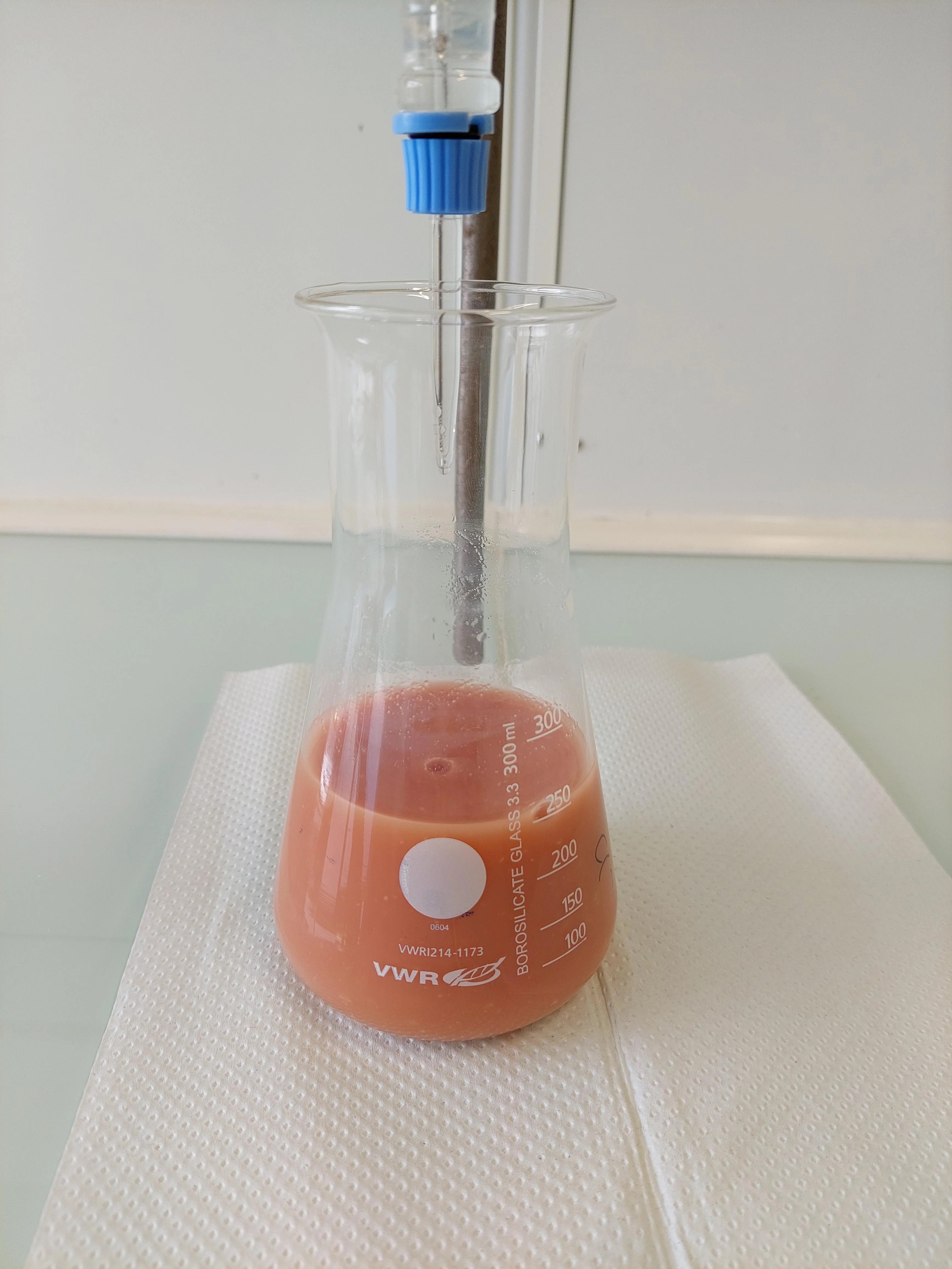

Determination of Chloride - Mohr's method of precipation titration
Mohr's method for the determination of chloride was founded by and named after german chemist Karl Friedrich Mohr (1806-1878). A solution of silver nitrate is added to the flask contaning chloride ions, potassium chromate is used as an indicator. While added, a precipate of silver chloride forms (Picture 1). The end point is indicated by the red-brown precipate of silver chromate (Picture 2). In the last picture i overshot the titration to better show the color of silver chromate. The titration is carried out in solutions with a pH of 6.5-9. If the solution is to acidic, the chromate will Form dichromate which won't Form an insoluble salt. If to basic, the added silver solution will Form silver oxid or silver hydoxide.
The method can also be used to determine the amount of bromide ions. It may be a little outdated, but still works nicely.
Note: potassium chromate (K2CrO4) is toxic and carcinogen. Silver nitrate is corrosive and can seriously damage your skin etc. Always be carefull!
https://www.reddit.com/r/chemistry/comments/13c1on1/determination_of_chloride_mohrs_method_of/
Определение хлоридов (количественный анализ) - титрование нитратом серебра методом Мора, индикатор - хромат натрия. Делал много раз: сначала - на пищевом предприятии (колбаса, рыба, консервы), потом - на гальванике (гальванические ванны, например, - ванна никелирования). Объекты - совсем разные, методика - одна и та же.
