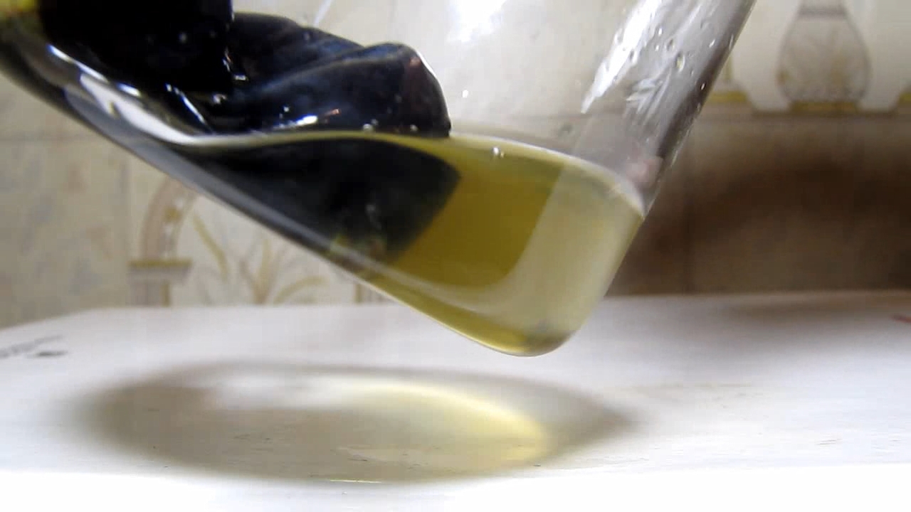

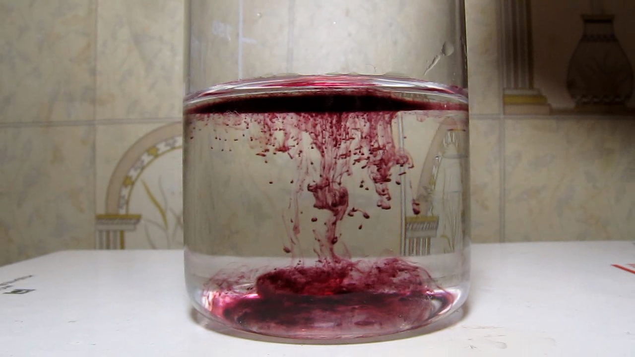

Prunus domestica and ammonia - pt.13
http://chemistry-chemists.com/N3_2023/C ... .html#1002

Dark blue grape and ammonia - pt.14
http://chemistry-chemists.com/N3_2023/C ... .html#1003

Sambucus ebulus (Danewort) and ammonia
http://chemistry-chemists.com/N3_2023/C ... -P2-7.html

Sambucus ebulus (Danewort), potassium hydroxide and hydrogen peroxide - pt.17
Sambucus_ebulus_potassium_hydroxide_hydrogen_peroxide-27.jpg [ 202.95 KiB | Viewed 10185 times ]

Red Prunus domestica (Plum), pink Grape, ammonia and nitric acid - pt.18
http://chemistry-chemists.com/N3_2023/C ... -P2-9.html
Red apple and ammonia - pt.19

How to turn red apple into black one - pt.20
http://chemistry-chemists.com/N1_2024/C ... -P1-1.html
