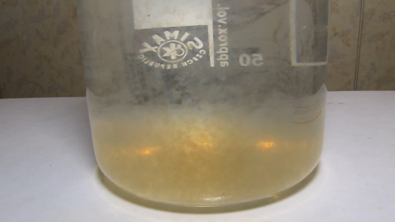

Lake water, water glass and iron (III) chloride - pt.4
http://chemistry-chemists.com/N3_2023/C ... .html#1002

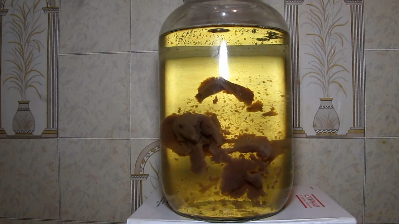

Lake water and aluminium sulfate - pt.7
http://chemistry-chemists.com/N3_2023/C ... .html#1003

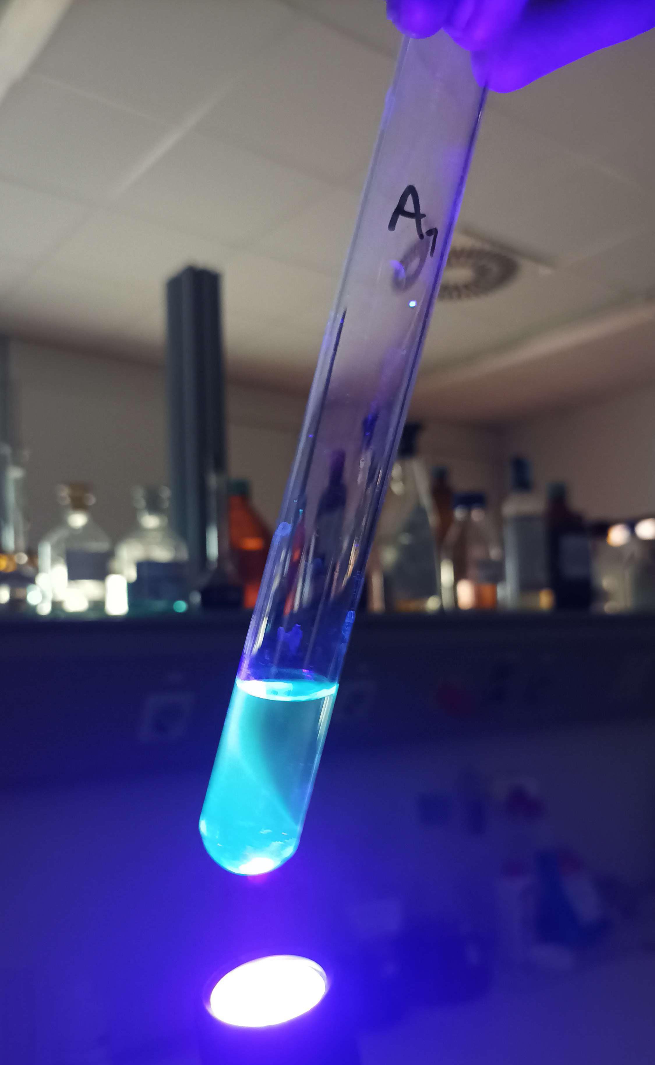

Hypsochromic shift of fluorescein in MEK
I think most people don’t know this, why I thought I’d share it with you: Ketones like in this case methylethylketone (MEK) can actually change the fluorescence of sergeant luminophores causing quite a notable hypsochromic shift (shift into a shorter, more energetic wavelength). This way the normally yellow-greenish fluorescing fluorescein can fluorescence bluish in this case.

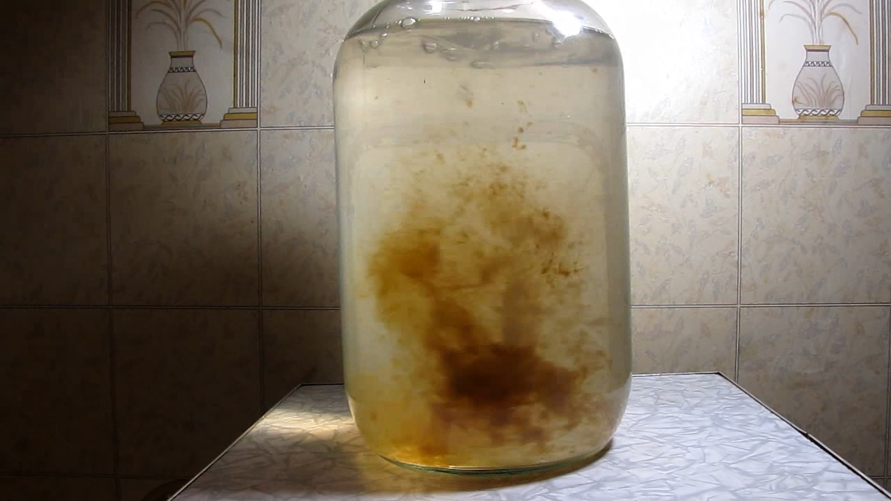

Black tea, tap water and aluminium sulfate (demonstration model of water treatment process) - p.11
http://chemistry-chemists.com/N3_2023/C ... -P7-5.html

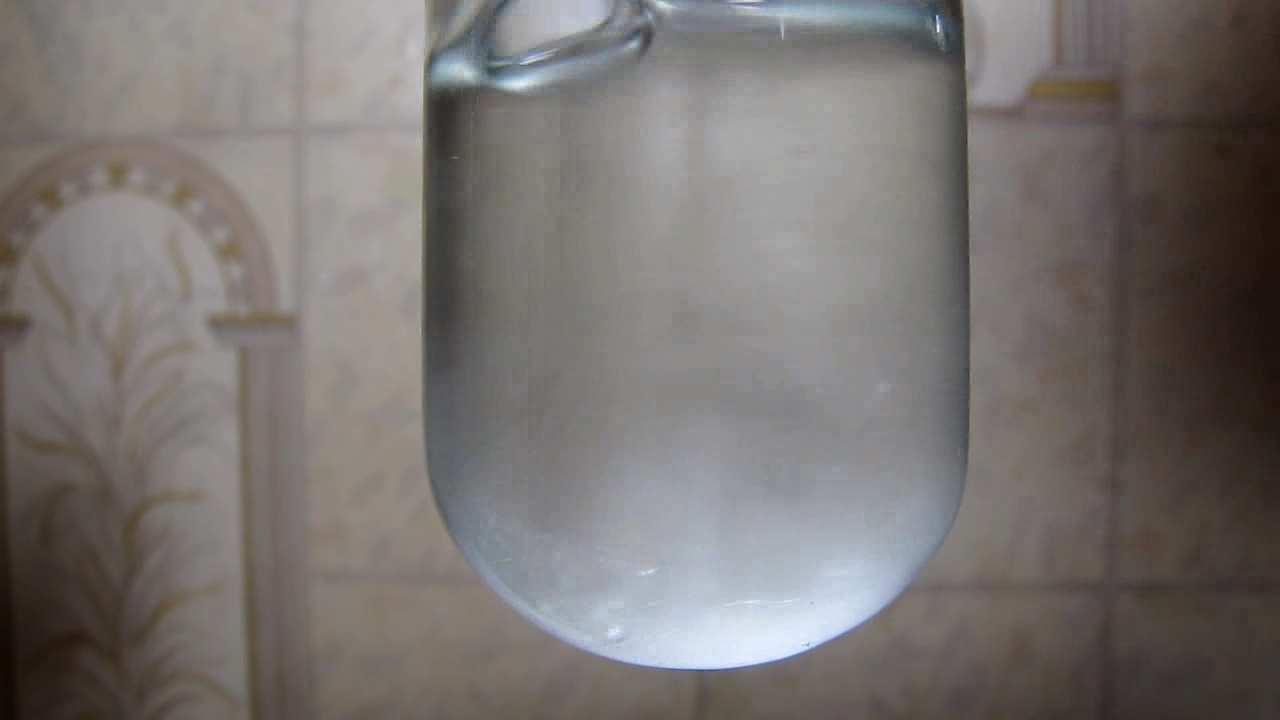

Castor oil, ethanol and water (oil dissolves in ethyl alcohol) - part 5
http://chemistry-chemists.com/N1_2024/C ... -P7-3.html
Let us dissolve water in oil! (Ethanol, castor oil and water) - part 6
http://chemistry-chemists.com/N1_2024/C ... .html#1002
