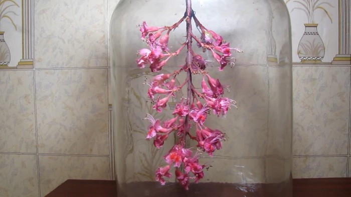

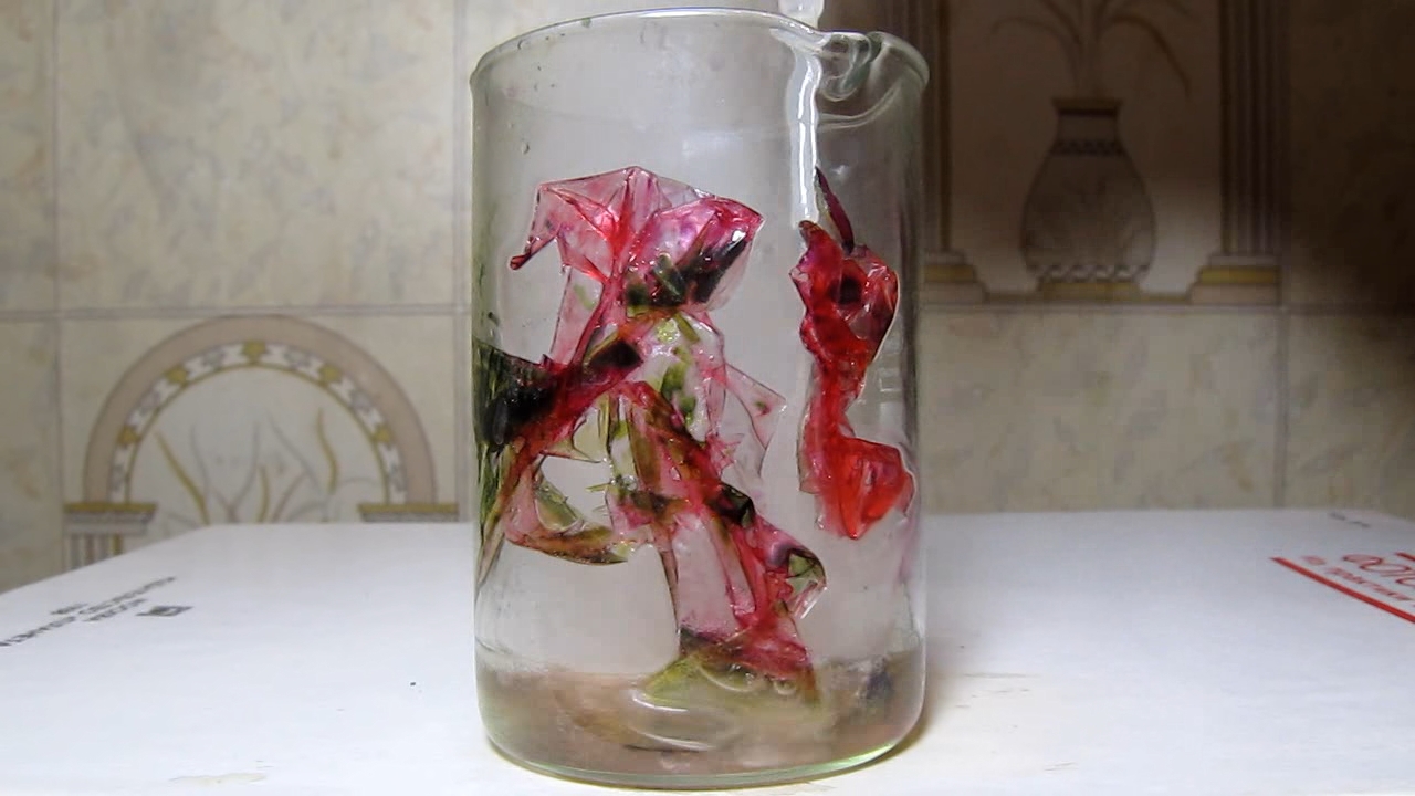

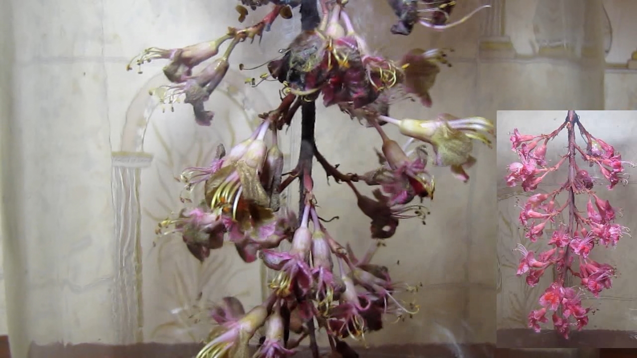

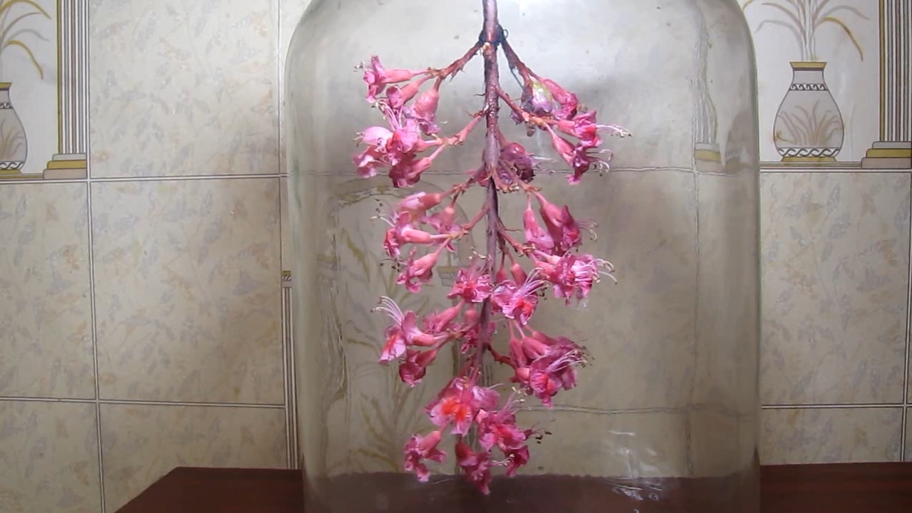

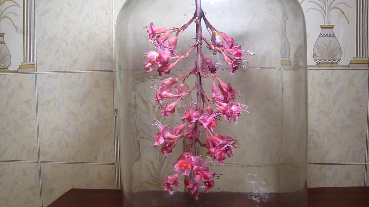

Red horse-chestnut flowers in atmosphere of ammonia - pt.4
http://chemistry-chemists.com/N3_2023/C ... .html#1002
The flowers of Red horse-chestnut were placed into an atmosphere of ammonia. The red flowers changed their color to pale grey-purple.
Unfortunately, the beautiful flowers lost their charm during the experiment.
Red_horse-chestnut_flowers_atmosphere_ammonia-1.jpg [ 421.57 KiB | Viewed 15698 times ]
Red_horse-chestnut_flowers_atmosphere_ammonia-15.jpg [ 446.94 KiB | Viewed 15698 times ]

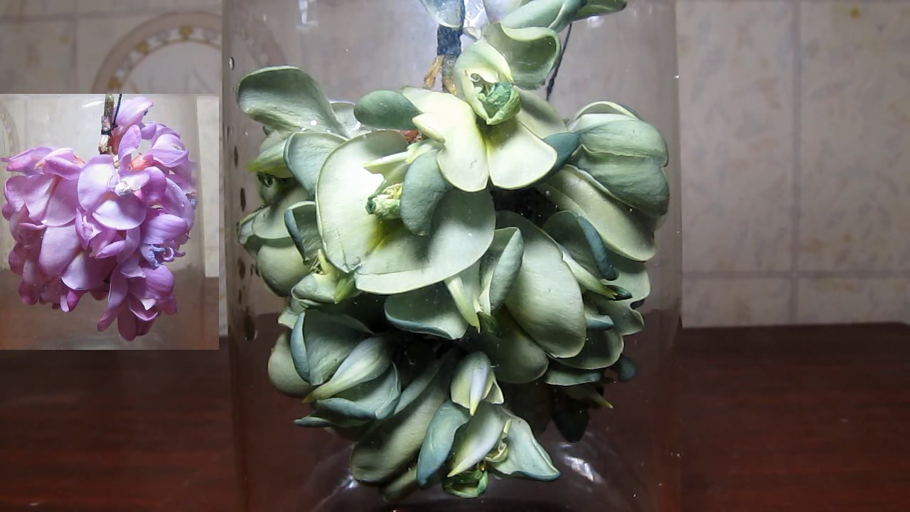

Robinia hispida flowers in atmosphere of ammonia - pt.5
http://chemistry-chemists.com/N3_2023/C ... .html#1003

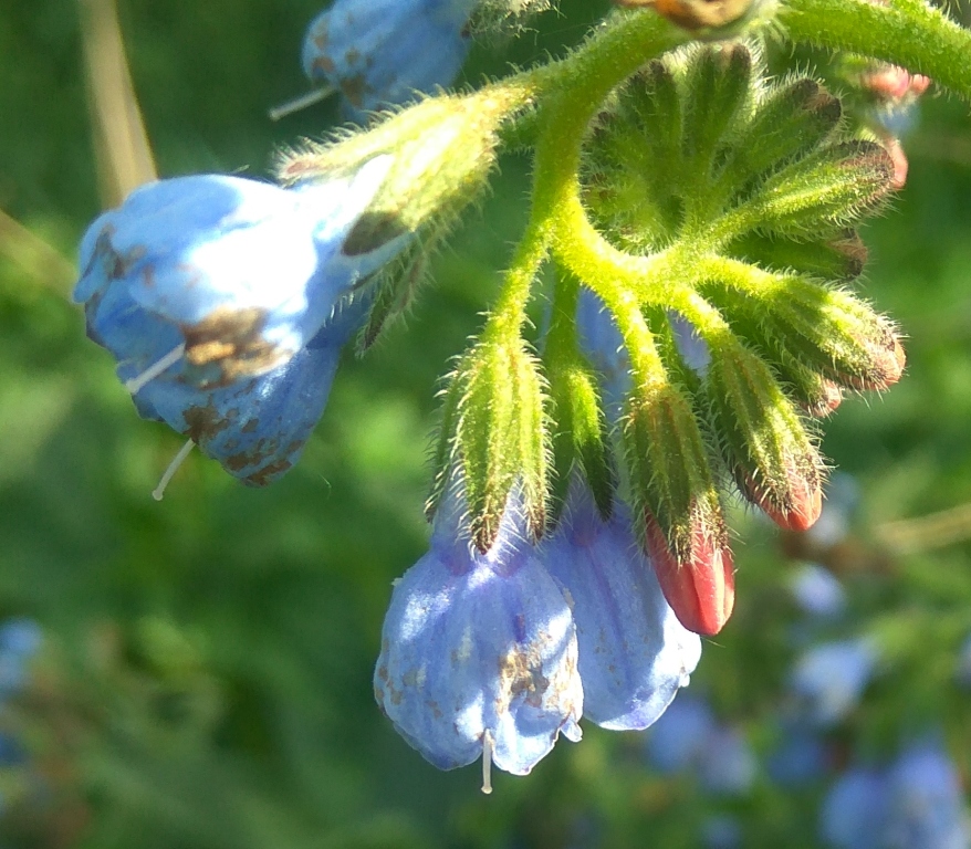

Symphytum asperum: pink and blue flowers - pt. 1a
http://chemistry-chemists.com/N3_2023/C ... html#10010

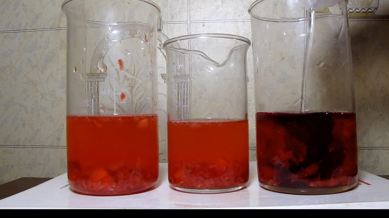

Strawberry, nitric acid, baking soda and ammonia (plant pigments colour change)
http://chemistry-chemists.com/N3_2023/C ... -P2-3.html
After a series of experiments with flowers, we used berries for the same purpose: to demonstrate the colour changes of plant pigments as the result of pH changes.
Chopped strawberries were mixed with distilled water to obtain a suspension ("a pasta" - partial homogenization). The liquid was divided into three parts. A concentrated ammonia solution was added to the first part.
The red-orange liquid became dark, burgundy-brown. A saturated sodium bicarbonate solution was added to the second part of the strawberry suspension. The liquid turned burgundy (lighter than previous one). A concentrated nitric acid was added to the third part of the liquid. The liquid colour did not change.
An excess of concentrated nitric acid was added to the first and second parts of the liquid (to neutralize ammonia or sodium bicarbonate). Both liquids returned to their original red-orange colour.
I hope that the colour changes in the next experiments would be more beautiful.

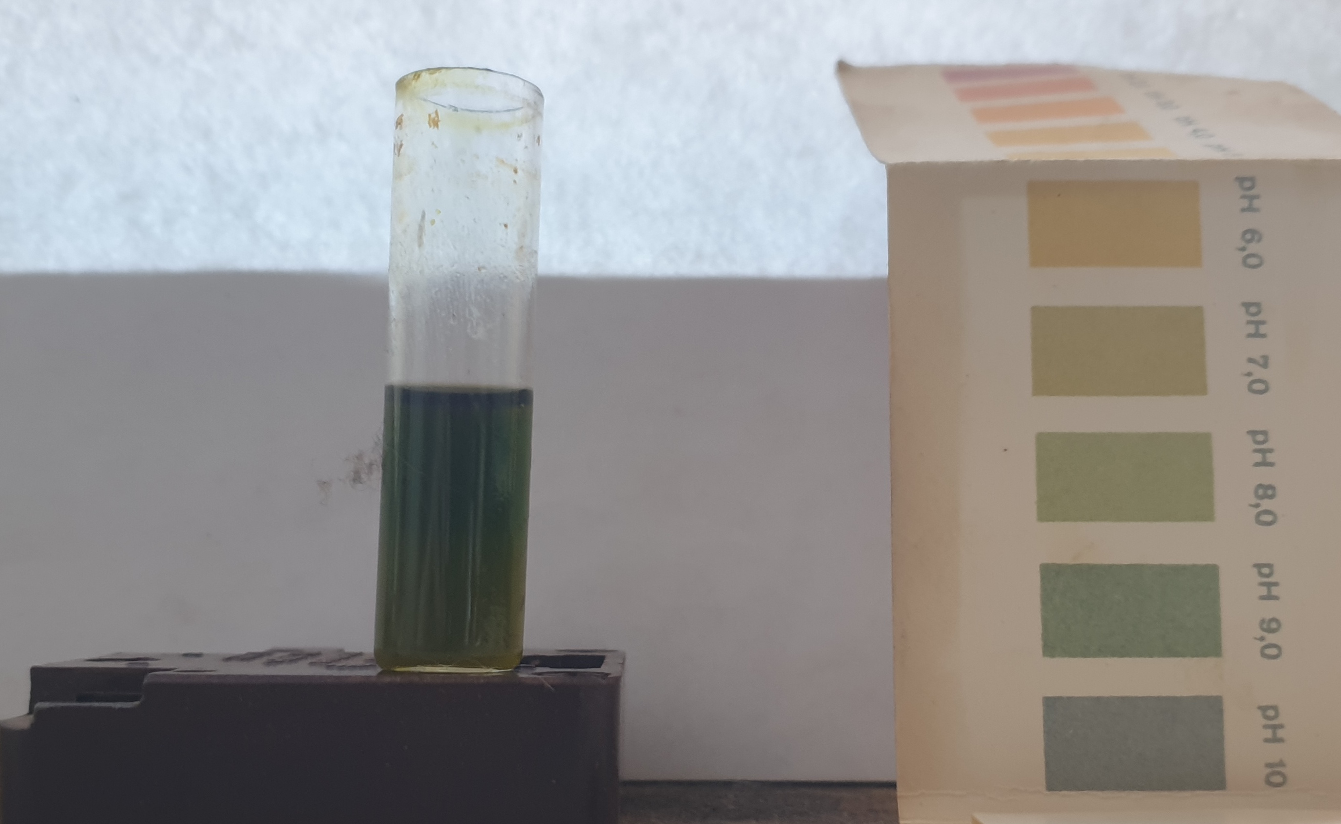

Чай каркадэ (гибискус).
Добавлена серная кислота (электролит).
Добавлен щелочь (крот).
 Post subject: Re: Цветочки и химия... (опыты с растениями и насекомыми)
PostPosted: 15 Jun 2023 21:16
Posts: 69208
Каркаде я попробовать не догадался. Нужно будет выбрать момент, когда где-то зацветет гибискус.
Цветная шкала от универсальной индикаторной бумаги (последнее фото) - немного другое. В смысле, что гибискус даст один цвет, а универсальный индикатор - другой. В составе бумажки - сразу несколько индикаторов. Думаю, что для бумаги, шкала которой на фото:
универсальный индикатор (по Богену) следующего состава: фенолфталеин (0,2 г), метиловый красный (0,4 г), диметиламинобензол (0,6 г), бромтимоловый синий (0,8 г), тимоловый синий (1,0 г), спирт этиловый (1 л), гидроксид натрия (до появления желтой окраски).
Есть и другое рецепты состава универсального индикатора.

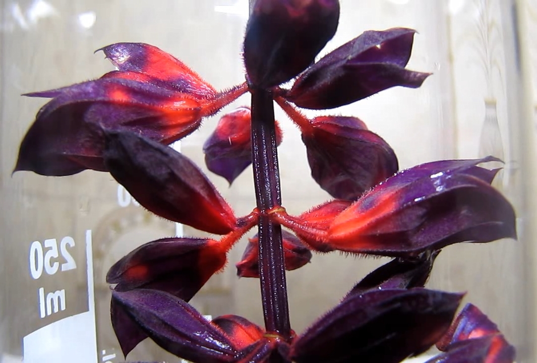

Salvia Splendens (''Red Salvia'') flowers, ammonia and hydrochloric acid - pt.8
http://chemistry-chemists.com/N3_2023/C ... -P2-4.html
In Ukraine, a bright red flowering plant is grown in flower beds. This flower is very common in our country as an ornamental plant. We call this plant "Chervona sal'viya" ("Red Salvia"), the biological name is Salvia Splendens. This species is native to Brazil but is grown in many other countries.
Salvia Splendens plants are usually grown in large groups, many bright red flowers look very beautiful - like a fire. Many years ago, I saw Salvia Splendens plants with dark blue flowers (maybe they were dark purple - I can't remember). Such plants of Salvia Splendens with dark blue flowers (instead of red ones) were very rarely found in our flower beds.
The red flowers of Salvia Splendens can be used for chemical experiments with plant dyes. The pigment(s) in these flowers is probably an acid-base indicator. Perhaps, the bright red colour will turn dark blue or dark purple in an atmosphere of ammonia? (I guess so, because there are Salvia Splendens plants with flowers of such colours).
A small amount of concentrated ammonia solution was poured in a glass. The red flowers were placed in the glass (suspended above the level of the solution). The red flowers of Salvia Splendens gradually turned dark purple.
Then these dark purple flowers (after the treatment with ammonia) were placed in an atmosphere of hydrochloric acid vapours. A thick smoke of ammonium chloride immediately formed. The dark purple flowers turned red. But this process was slow, the flowers were doused by hydrochloric acid to speed up the colour transformation. The plant tissues of the flowers were partially destructed by the strong acid.

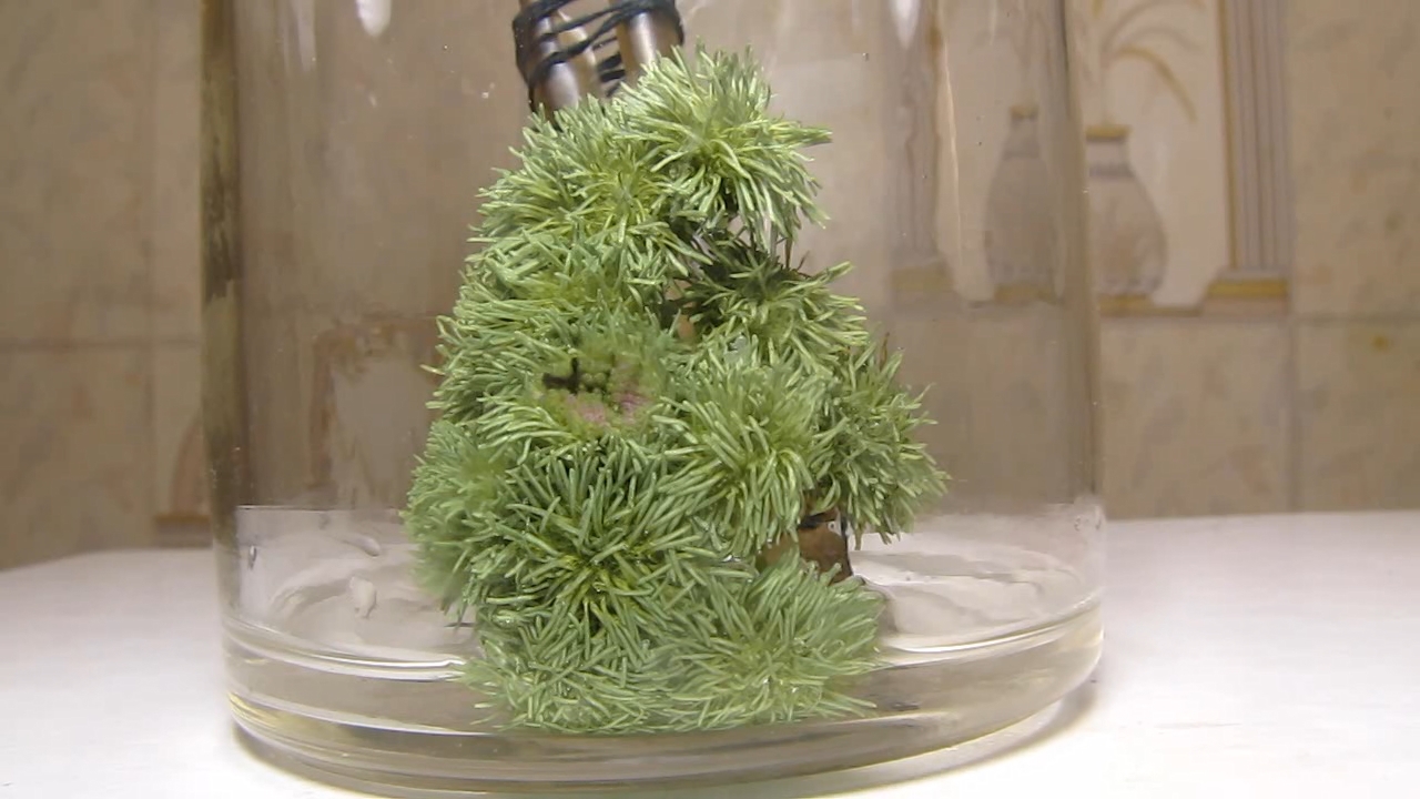

Ageratum Houstonianum: flowers become like green moss - pt.10
http://chemistry-chemists.com/N3_2023/C ... -P2-5.html
Ageratum Houstonianum is an ornamental plant which is widely grown in flower beds and gardens. The violet flowers of this plant were used for the next experiments.
An ammonia solution was poured into the bottom of a glass, the flowers was placed in the glass. In an atmosphere of ammonia, the violet flowers became grey, then green. As a result, an inflorescence looked like green moss.
The green flowers were placed in the new glass, then glacial acetic acid was added. The colour gradually changed to violet, then to pink and, finally - to pink-orange.
New violet flowers of Ageratum Houstonianum were placed into the same beaker with glacial acetic acid. The flowers turned pink, then they turned pink-orange.
After that, the flowers of Ageratum Houstonianum were being completely immersed into glacial acetic acid for 1 hour. The pink-orange solution was formed. This solution was used for the next experiment.
A concentrated ammonia solution was gradually added to the solution of the plant dye (in acetic acid). Fist, the pink-orange solution turned colourless then it became a bright greenish-yellow colour (final pH was 9-10). Then concentrated hydrochloric acid was slowly added. The bright greenish-yellow solution first turned pale yellow then turned pale orange (unfortunately, during our experiment, the solution was diluted, so all colours turned pale). The final pH was <=1.

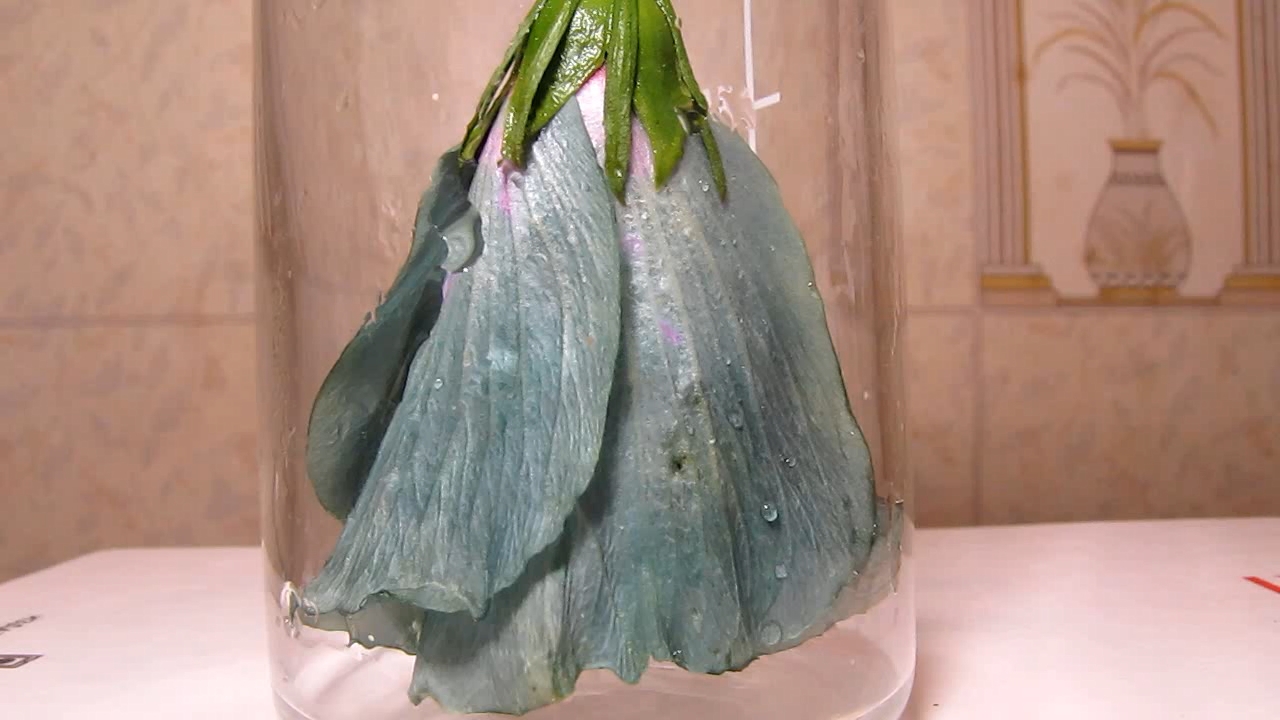

Hibiscus Syriacus flowers, ammonia and acetic acid - pt.11
A few years ago, bushes (or small trees) with large, beautiful flowers appeared in our parks and gardens. The colour of the flowers was different, but the shape was similar. I wonder... What kind of plant is this? I photographed the plant and posted photos on the chemical forum. A colleague suggested that this is Hibiscus Syriacus.
The homeland of the plant is Asia (as you might guess from the name). It grows in China, Korea and Western Asia. A hardy plant with high tolerance to heat, drought, poor soils and air pollution (ideal for cities). The colours of the flowers of Hibiscus Syriacus vary widely, with petals ranging from white to bright red depending on the cultivar. The shape of the flower may also differ from the usual one (no one cancelled the selection).
Thanks to its beautiful flowers, Hibiscus Syriacus is grown as an ornamental plant far beyond its natural range. In particular, on the open ground (not in a greenhouse) they began to cultivate it in the south of Ukraine and in Moldova. It is interesting that I saw Hibiscus Syriacus in Kyiv, and this is already the north of Ukraine. Even without referring to the literature, one can guess that the southern plant is unlikely to be resistant to frost, but the climate is changing - winters are getting warmer. The tree shown in the photographs below has been growing for several years and no one covered it for the winter...

Upd.
After the experiment I went back to the Hibiscus Syriacus tree to take some better photos. Suddenly I saw that my previous observations were not accurate. During all time of flowing, the petals of the flowers are pink. The pink petals turn blue as the flowers are fading (but when the buds are opening, the petals are pink not blue). Fortunately, it does not change general conclusions: the pH change in tissue leads to the change of the colour of the plant dye. And at this time, the flowers are on the tree, not in the beaker (with ammonia).
Upd.
После эксперимента я вернулся к дереву Hibiscus Syriacus, чтобы сделать несколько фотографий получше. Внезапно увидел, что мои предыдущие наблюдения были неточными. Все время цветения лепестки цветков розовые (не синие). Розовые лепестки становятся частично синими, когда цветы увядают (зато когда бутоны раскрываются, лепестки розовые, а не синие). К счастью, это не меняет общих выводов: изменение рН в растительной ткани приводит к изменению окраски растительного красителя. И в это время цветок находится на дереве, а не в химическом стакане (с аммиаком).

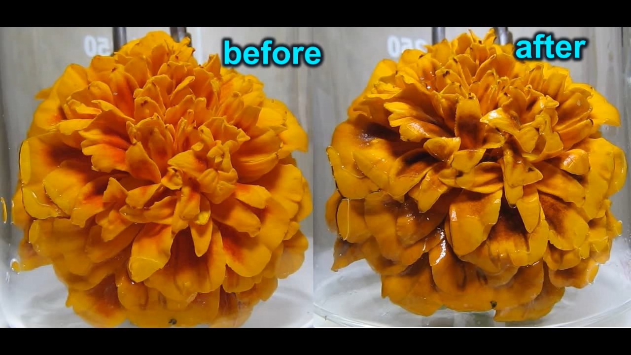

Tagetes flower and ammonia - p.12
http://chemistry-chemists.com/N3_2023/C ... -P2-6.html
