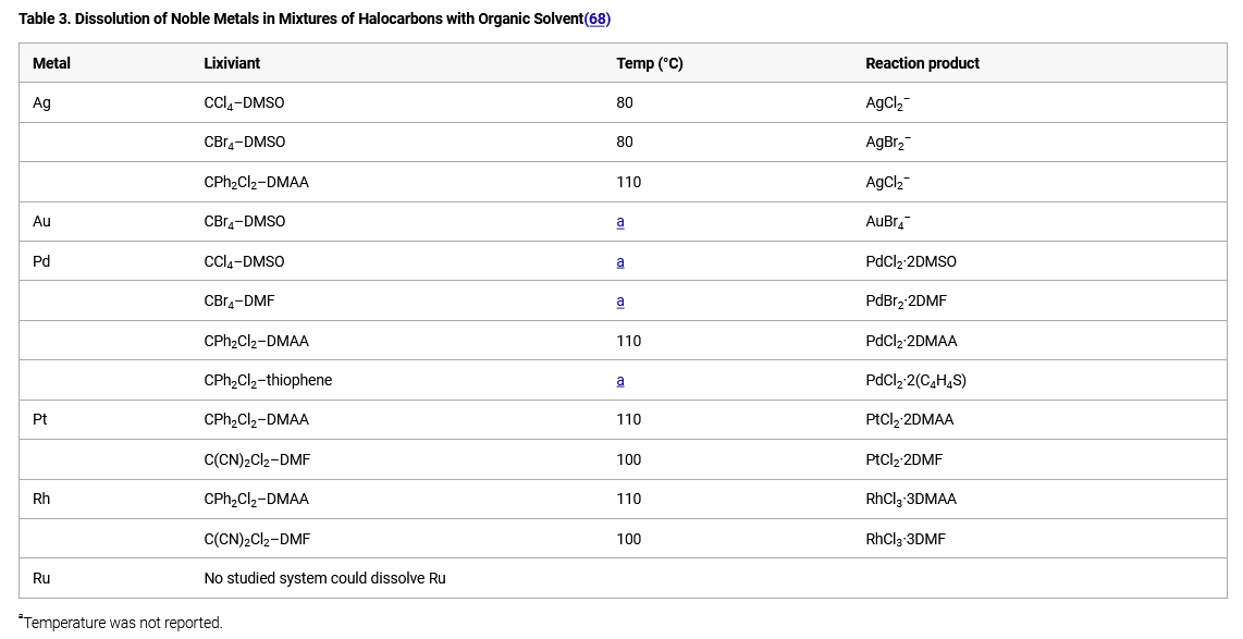

Берс wrote:
Жаль. А может вы знаете неводное соединение которое могло бы растворять благородные металлы
Их сколько угодно: смеси с ДМСО (например, ДМСО + бутилбромид растворяет золото), хлориды и оксохлориды серы (и смеси с их участием), ртуть.
Interesting, how this reactions going? How reagction equations looks like?
 Post subject: Re: Серебро, золото, платиновые металлы (химия, выделение)
PostPosted: 12 Sep 2021 22:30
Posts: 69152

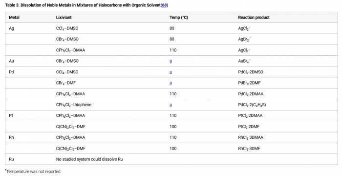

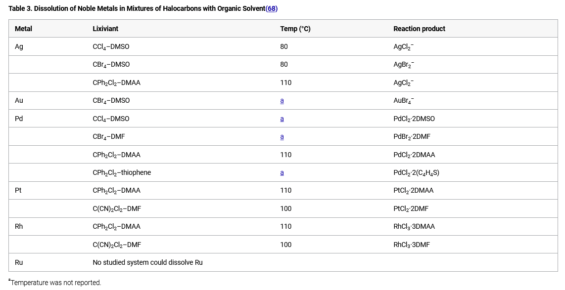

1. DMSO + CCl4 (and similar)
Organic halides (halocarbons) can act as oxidizing agents in polar organic solvents and have been used for dissolution of metals with the aim of direct synthesis of metal complexes. Tezuka et al. studied the oxidative dissolution of copper by halocarbons in dimethyl sulfoxide (DSMO) with the formation of the complex CuCl2(DMSO).(64)
Both the halocarbon and the polar solvent played an important role in the dissolution process. The most studied halocarbon was carbon tetrachloride (CCl4), but other halocarbons could be used as oxidizing agents as well, such as diphenyldichloromethane, dichloroacetic acid, or trichloroacetic acid esters and bromoalkanes (e.g., carbon tetrabromide). DMSO could not be replaced by other polar organic solvents, such as methanol, tetrahydrofuran, benzene, chloroform, acetonitrile, or pyridine. The dissolution mechanism is described by eqs 7–9. First, copper is oxidized by CCl4-DMSO with the formation of CuCl2(DMSO)2 and dichlorocarbene (:CCl2). The dichlorocarbene instantaneously reacts with DMSO to produce dimethyl sulfide and phosgene. Phosgene directly reacts further with copper to form CuCl2(DMSO)2 and carbon monoxide.
Oxidative Dissolution of Metals in Organic Solvents.png [ 6.29 KiB | Viewed 17219 times ]
- in the case of gold (CBr4) the reactions should be the same
Oxidative Dissolution of Metals in Organic Solvents.png [ 39.44 KiB | Viewed 17219 times ]
full text
File comment: Oxidative Dissolution of Metals in Organic Solvents
Oxidative Dissolution of Metals in Organic Solvents.pdf [6.53 MiB]
Downloaded 742 times

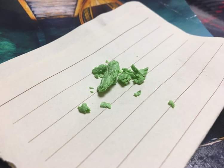

Once i made copper chloride DMSO complex. I dissolved anhydrous CuCl2 in isopropanol and add DMSO, compound has yellow colour, but this contains little bit more DMSO and it is green.

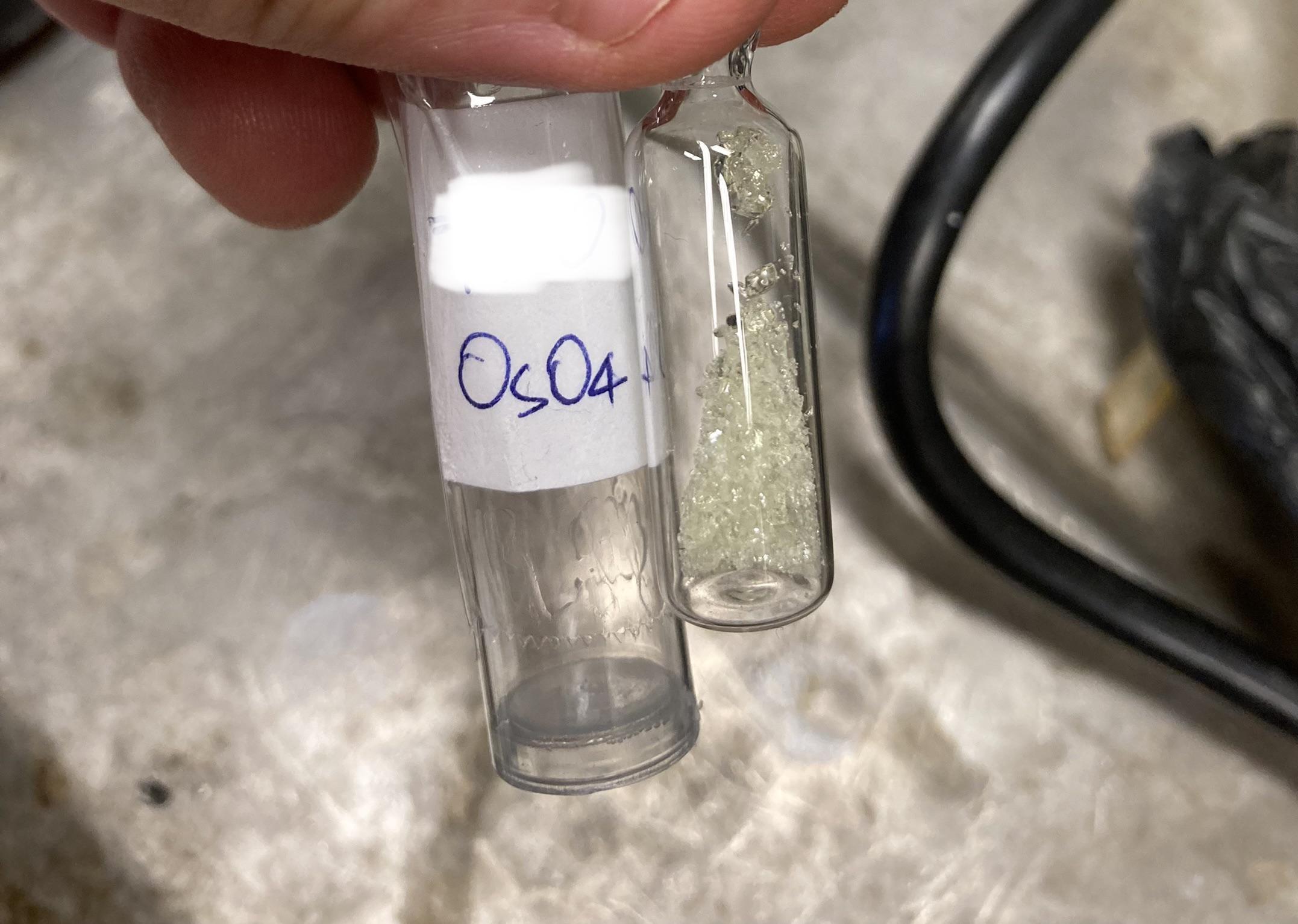

Четырехокись осмия в ампуле по 1 г (цена - 400 $)

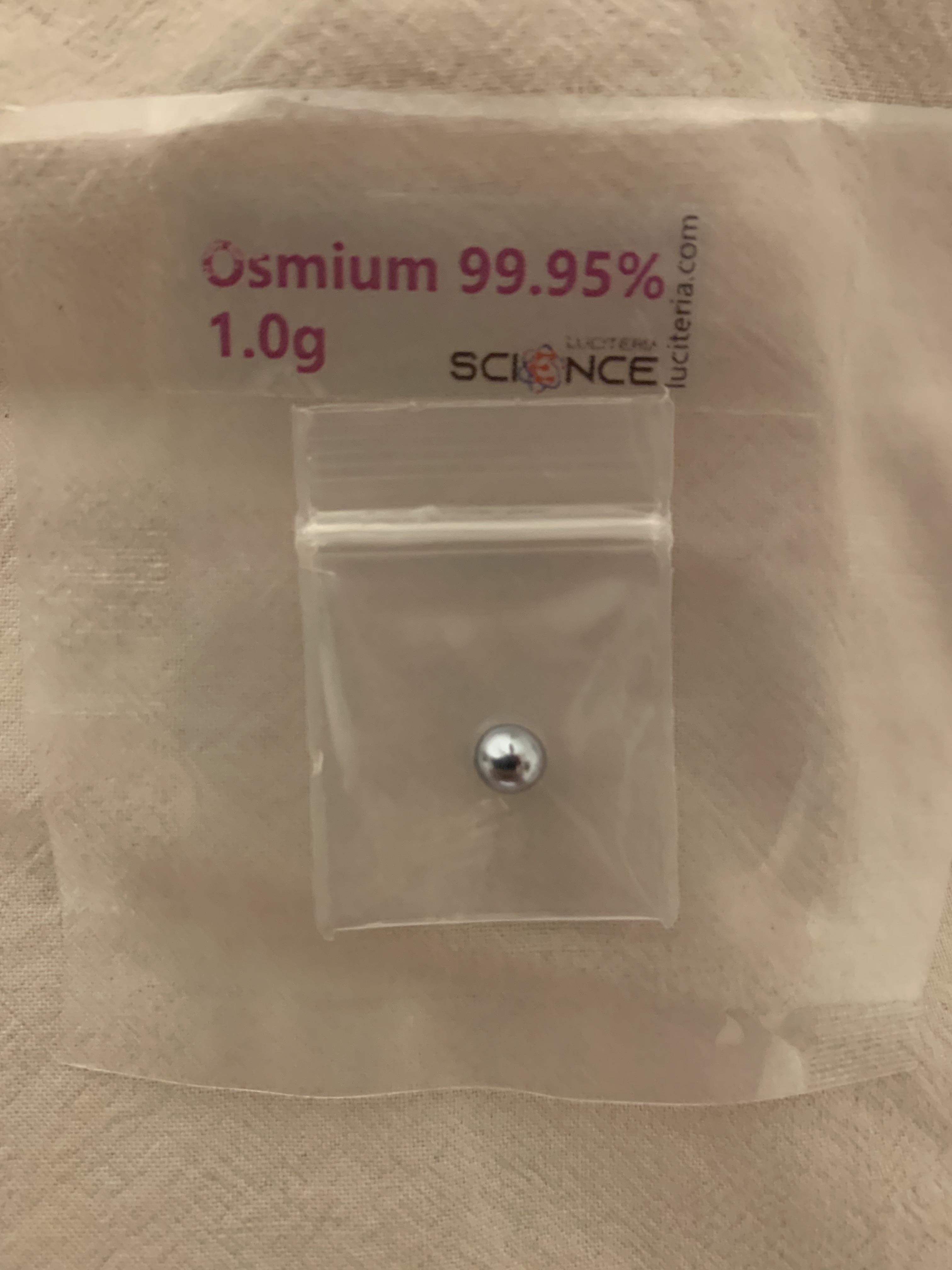

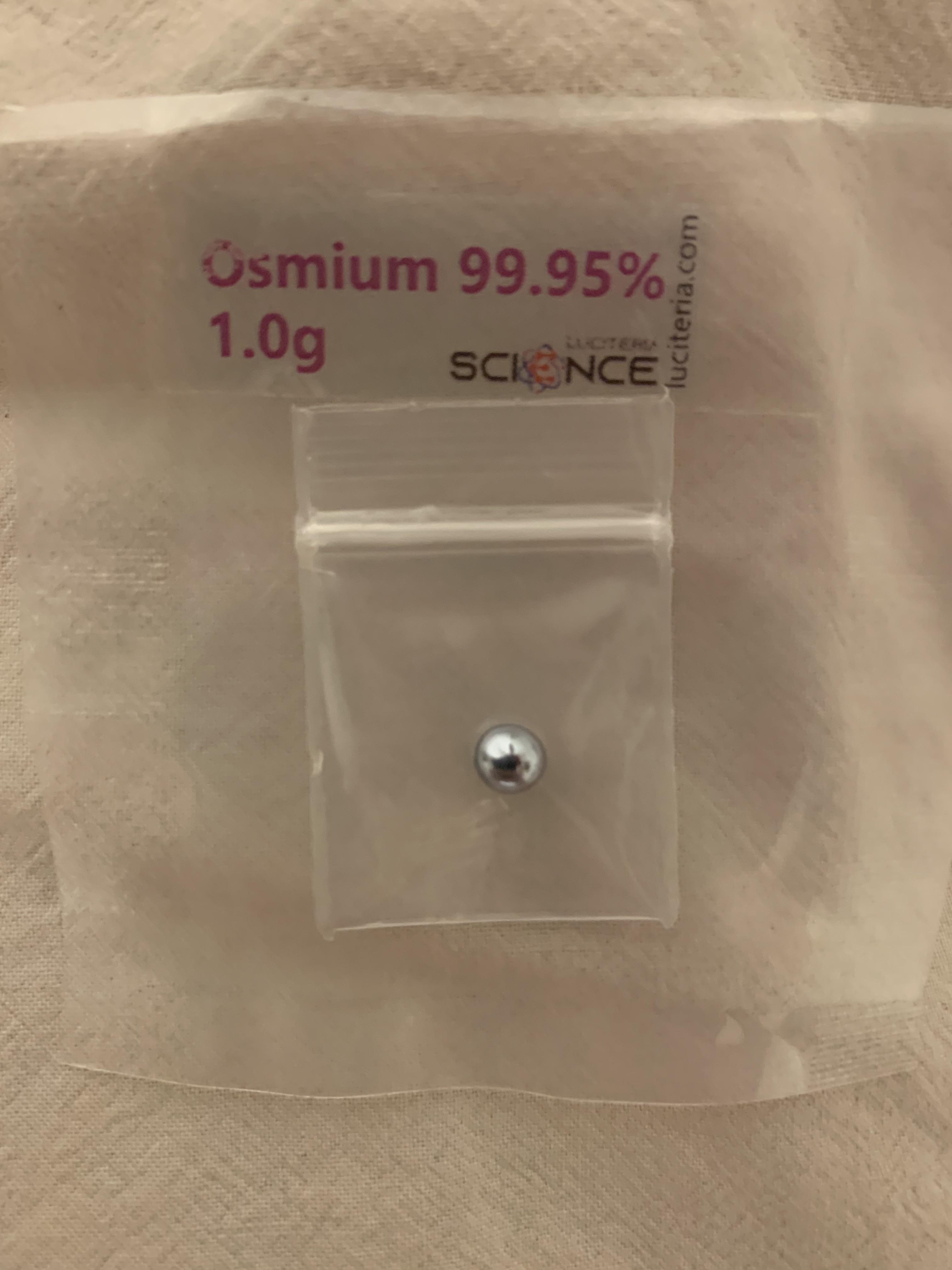

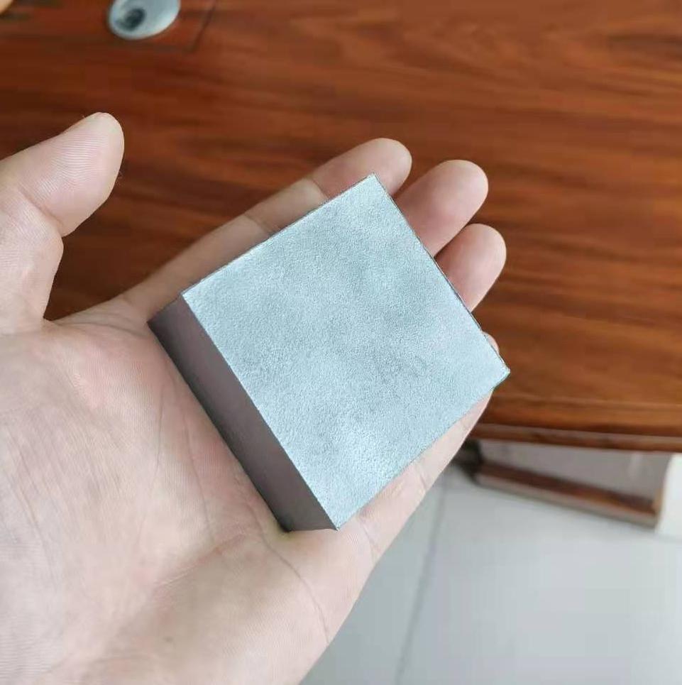

3 кг осмия
1 г осмия

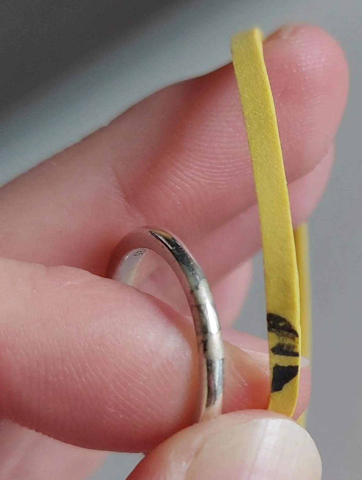

Серебряное кольцо после контакта с желтой резинкой - похоже, что образовался черный сульфид серебра за счет серы, которую добавили в каучук при вулканизации

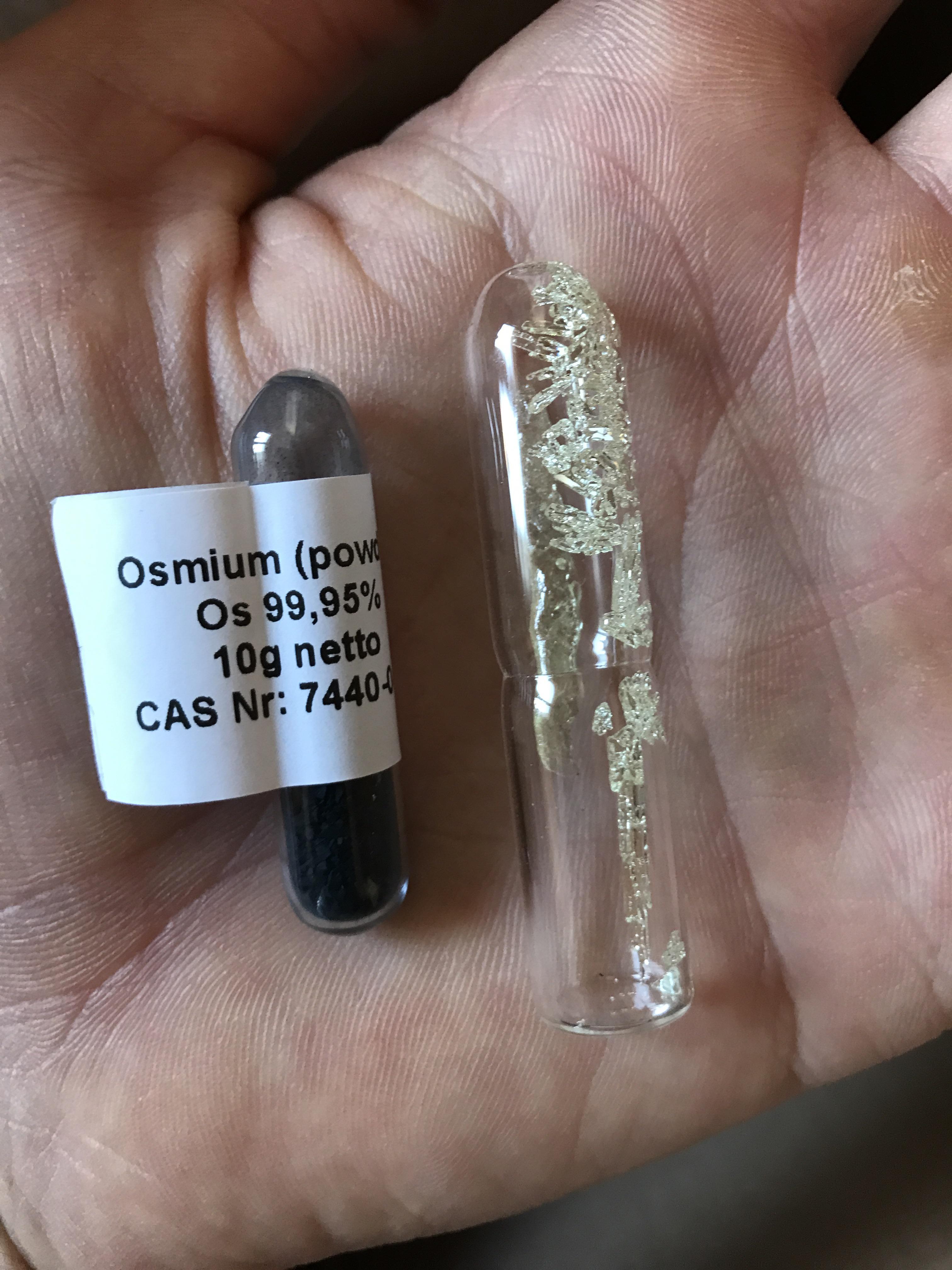

Порошок осмия и тетраоксид осмия:
Osmium (Os) powder next to 1g of deadly osmium tetroxide (OsO4).jpg [ 849.6 KiB | Viewed 14599 times ]

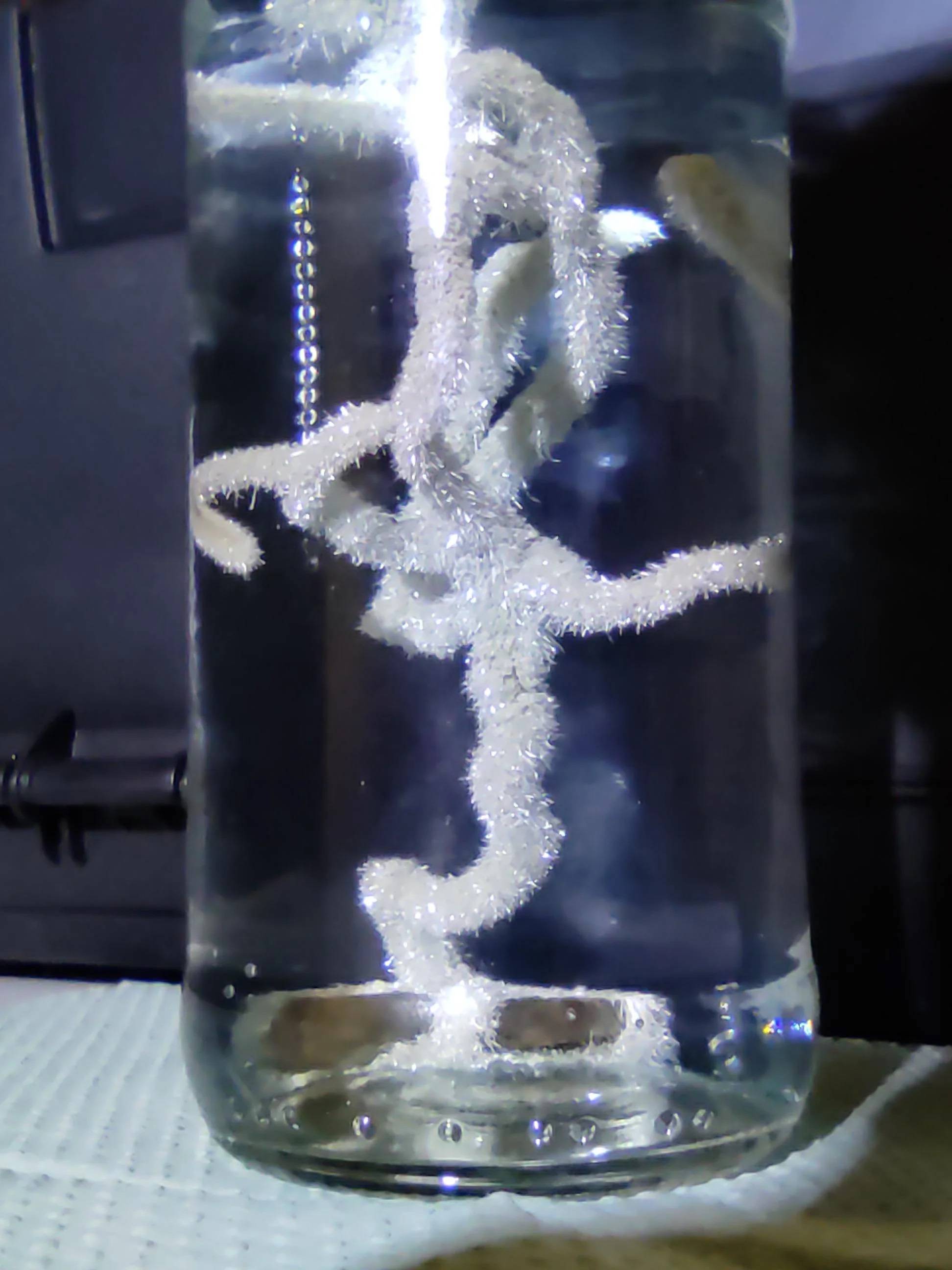

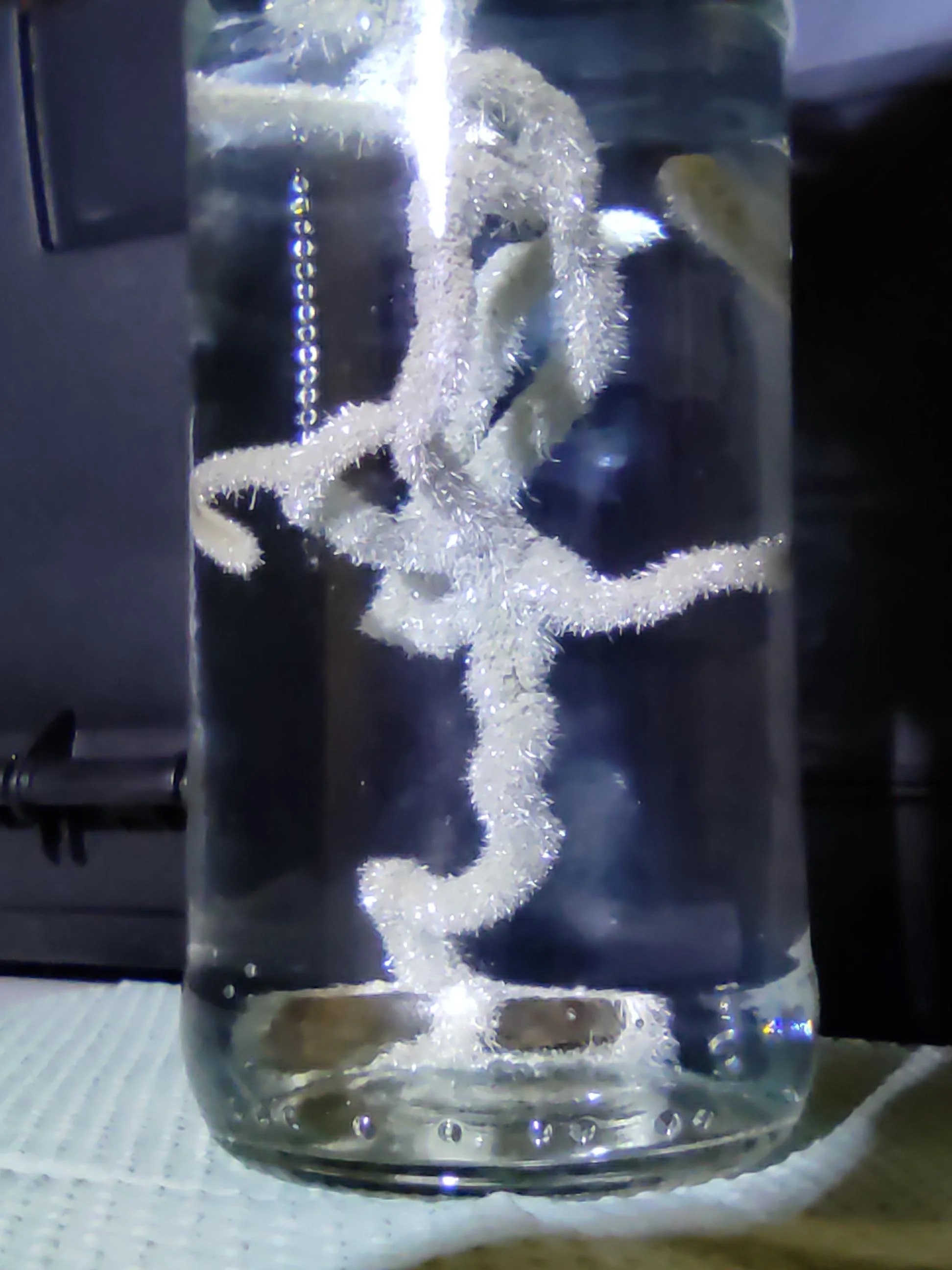

Медная проволока в растворе нитрата серебра

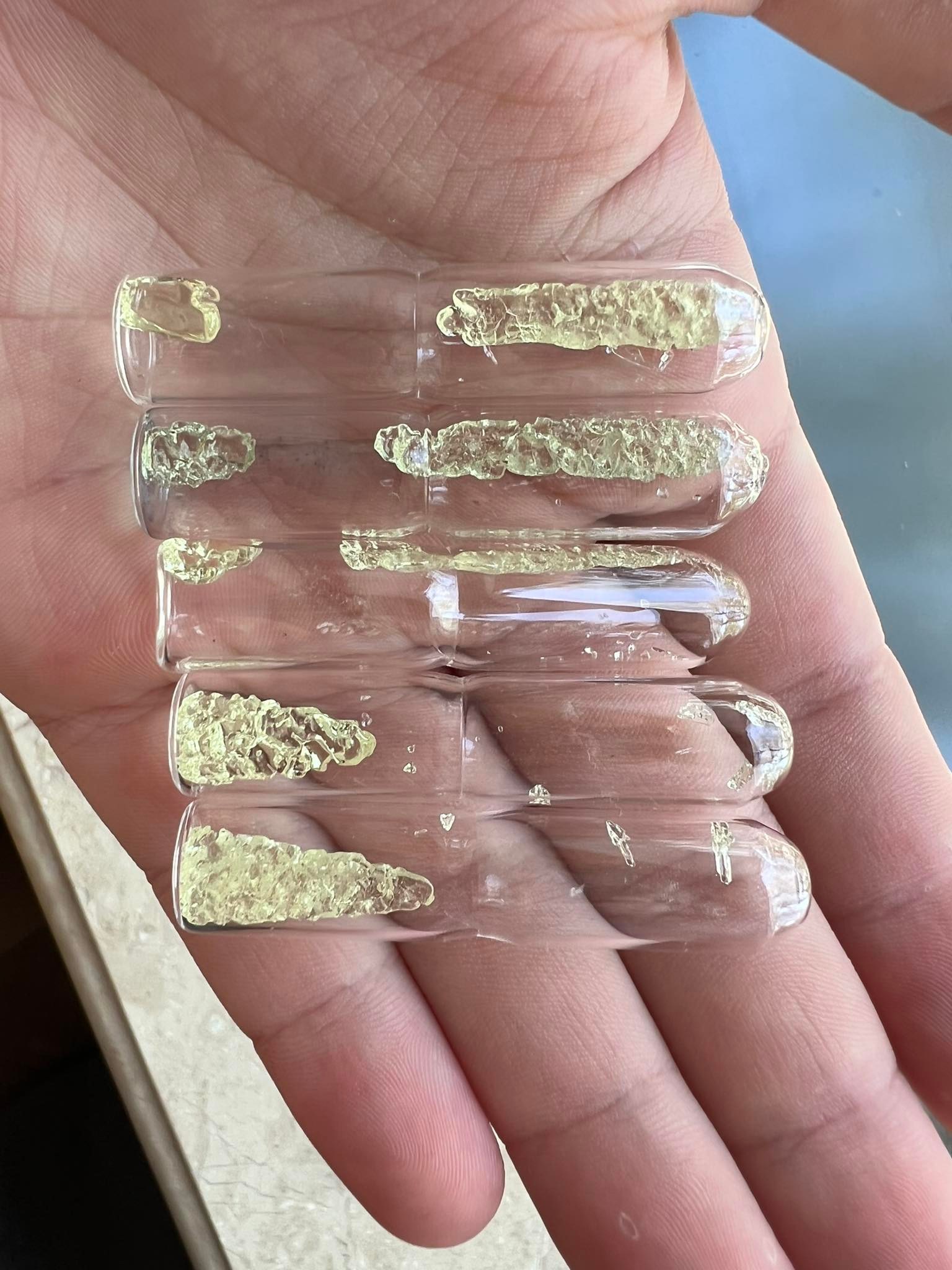

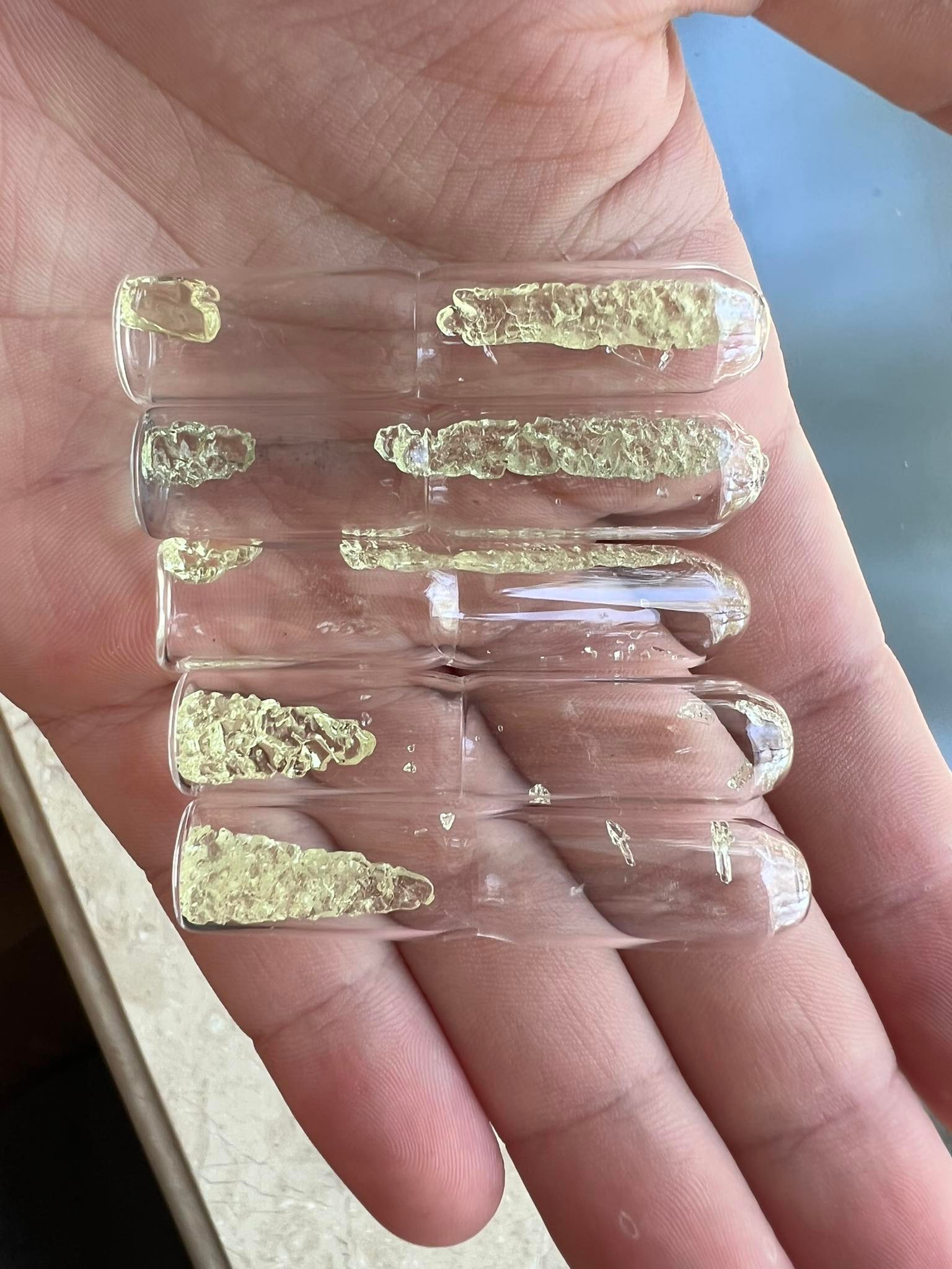

5g osmium tetroxide for my home laboratory. made in south africa republic.
298380273_749957986118522_2118277876779586959_n.jpg [ 346.04 KiB | Viewed 14155 times ]
298436411_2959465337683528_5627542164742390873_n.jpg [ 286.09 KiB | Viewed 14155 times ]

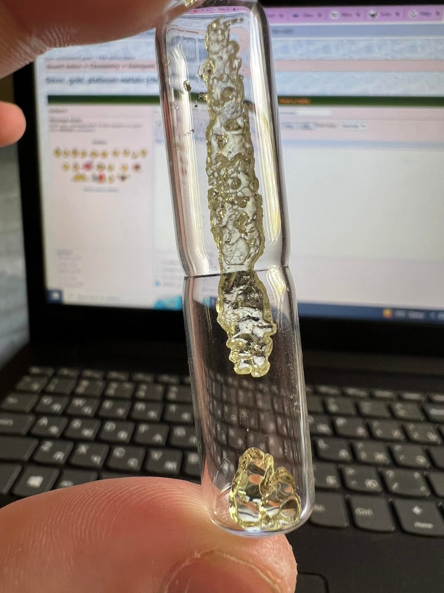

Показую фото коллеге:
- Это уже H[AuCl4]?
В ответ улыбаюсь.
- Чай?
- Да
(беру в руки чашку с чаем - тоже из бесцветного стекла, но не стилизованную под химический стакан).
