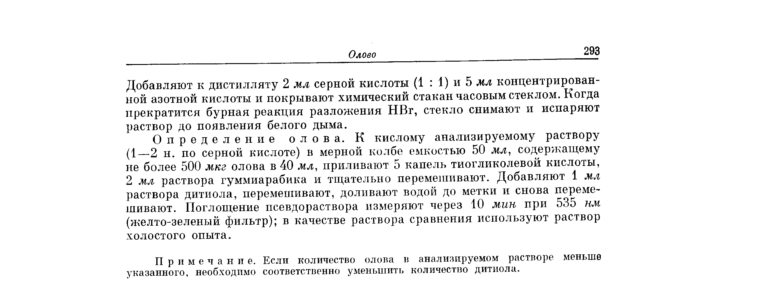

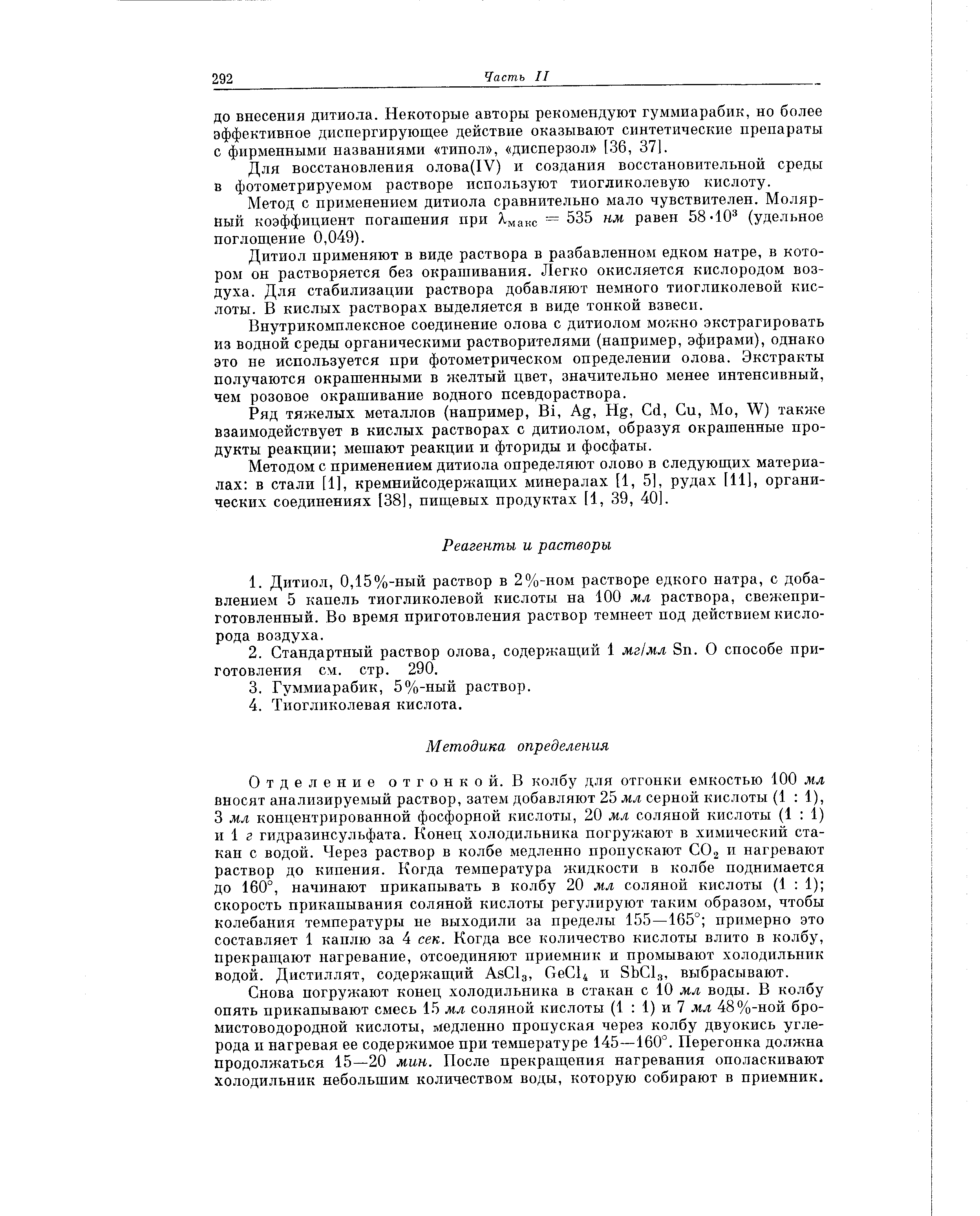

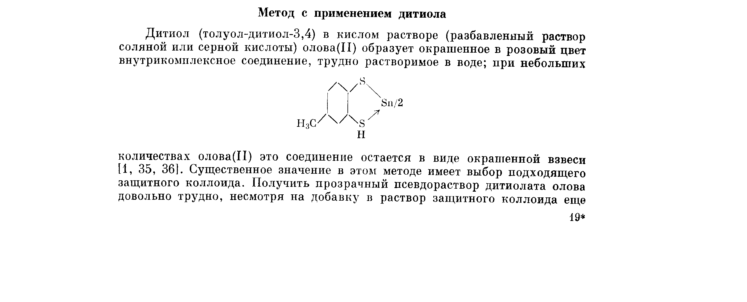

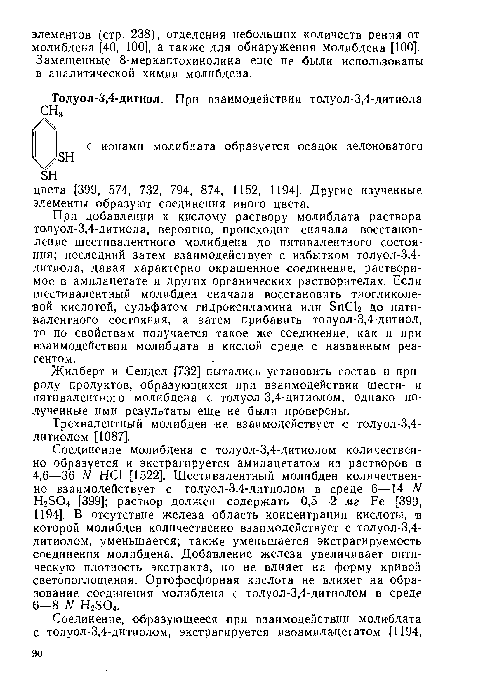

hello. what interesting things i can make with toluene-3,4- dithiol in organic synthesis, complexes, etc.?
PostPosted: 01 Jun 2022 10:19
Posts: 69305
This is an analytical reagent. For example, for tin and molybdenum.
Clark, R. E. D.; Neville, R. C. (1959). Toluene-3,4-dithiol and its derivatives as analytical reagents: A new approach to qualitative inorganic analysis. // Journal of Chemical Education, 36(8), 390–
File comment: Clark, R. E. D.; Neville, R. C. (1959). Toluene-3,4-dithiol and its derivatives as analytical reagents: A new approach to qualitative inorganic analysis. // Journal of Chemical Education
ed036p390.pdf [4.08 MiB]
Downloaded 338 times
Sn -
Марченко З. Фотометрическое определение элементов (1971) viewtopic.php?p=27452#p27452
Mo -
Бусев А.И. - Аналитическая химия молибдена http://chemistry-chemists.com/book5/him ... ov/Mo.djvu

thanks! I just want a solid complex in the vial, can i make it easily what do you think?
PostPosted: 01 Jun 2022 18:55
Posts: 69305
The complex with tin is insoluble in water. Dithiol is used as a solution in 2% sodium hydroxide. The solution is oxidized by air - prepare before synthesis.
(the quote from the book is in the post above).
