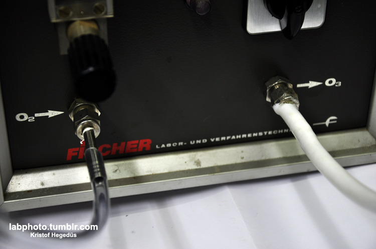

Озонатор
https://labphoto.tumblr.com/post/260170 ... c-chemical
