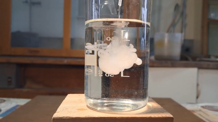

Reaction of Sodium Carbonate with Sodium Chloride
http://chemistry-chemists.com/N3_2025/C ... -P3-1.html
Reaction_of_Sodium_Carbonate_with_Sodium_Chloride-7.jpg [ 277.17 KiB | Viewed 1500 times ]

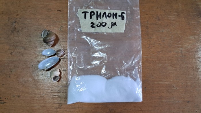

Dissolving Mollusk Shells in EDTA
Trilon B, Ammonia, and Mollusk Shells - Part 1
http://chemistry-chemists.com/N3_2025/C ... -P8-1.html

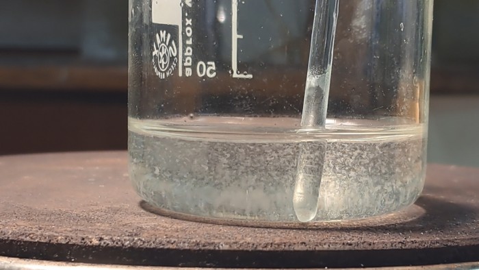

Reaction of Disodium Salt of EDTA and Calcium Carbonate - Part 3
http://chemistry-chemists.com/N3_2025/C ... -P8-2.html
Reaction_Disodium_Salt-EDTA-Calcium-Carbonate-17.jpg [ 342.39 KiB | Viewed 401 times ]

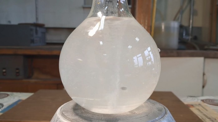

Disodium Salt of EDTA and Calcium Sulfate - Part 4
http://chemistry-chemists.com/N3_2025/C ... .html#1002

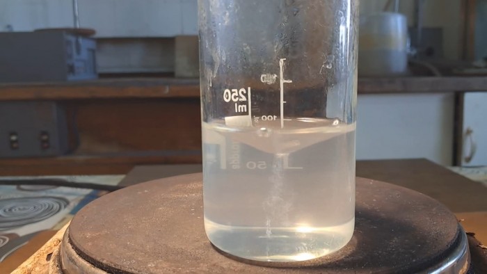

Experiments with Sparingly Soluble Calcium, Strontium, and Barium Salts
Dissolving Calcium Sulfate in Water - Part 1
http://chemistry-chemists.com/N3_2025/C ... P10-1.html
