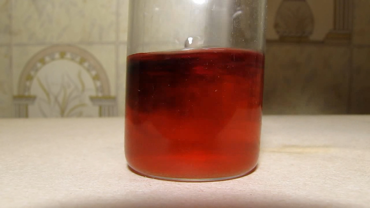

Horse chestnut bark, ethanol, water and iron (III) chloride
http://chemistry-chemists.com/N1_2024/C ... -P6-3.html
Horse_chestnut_bark-ethanol-water-iron_III_chloride-6.jpg [ 378.45 KiB | Viewed 20590 times ]
