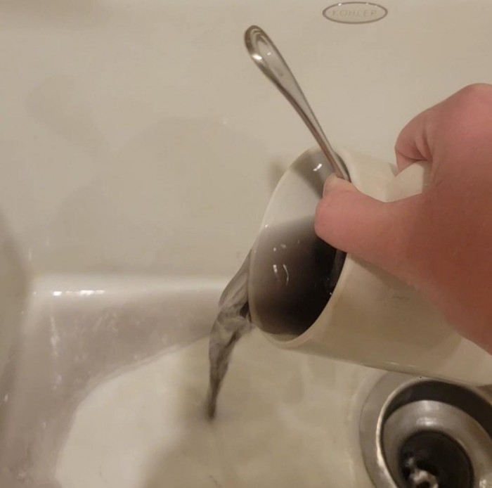

Tea turned pitch black?
I boiled water tonight. It was just slightly orange from a bit of rust when I poured it in the mug. When I added a green tea bag, in almost instantly turned pitch black. Can anyone explain what happened? Is it likely safe to drink?
И кто бы мог подумать...
