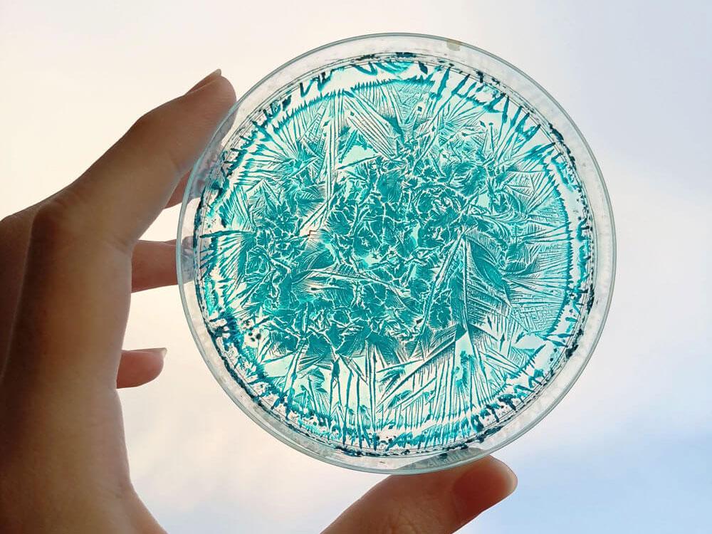

I left some copper acetate solution to evaporate in a dish. This is what it looked like after it dried

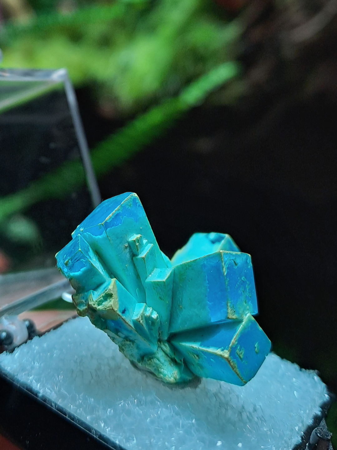

Copper-iron sulfate crystal after a year
The crystal was coated in acrylic varnish and in a plastic box. The dehydration started at the base and progressed upwards. This is probably because the lower you go on the crystal, the more little nooks and cranies there is so the varnish probably didn't go everywhere.

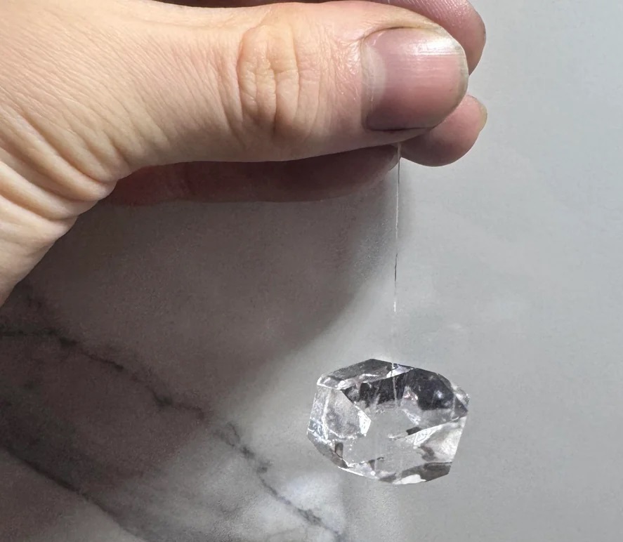

Citric acid
9.04 grams after a month of babysitting at 16°C. The growing was kinda easy, everything just needs to be slow-paced.

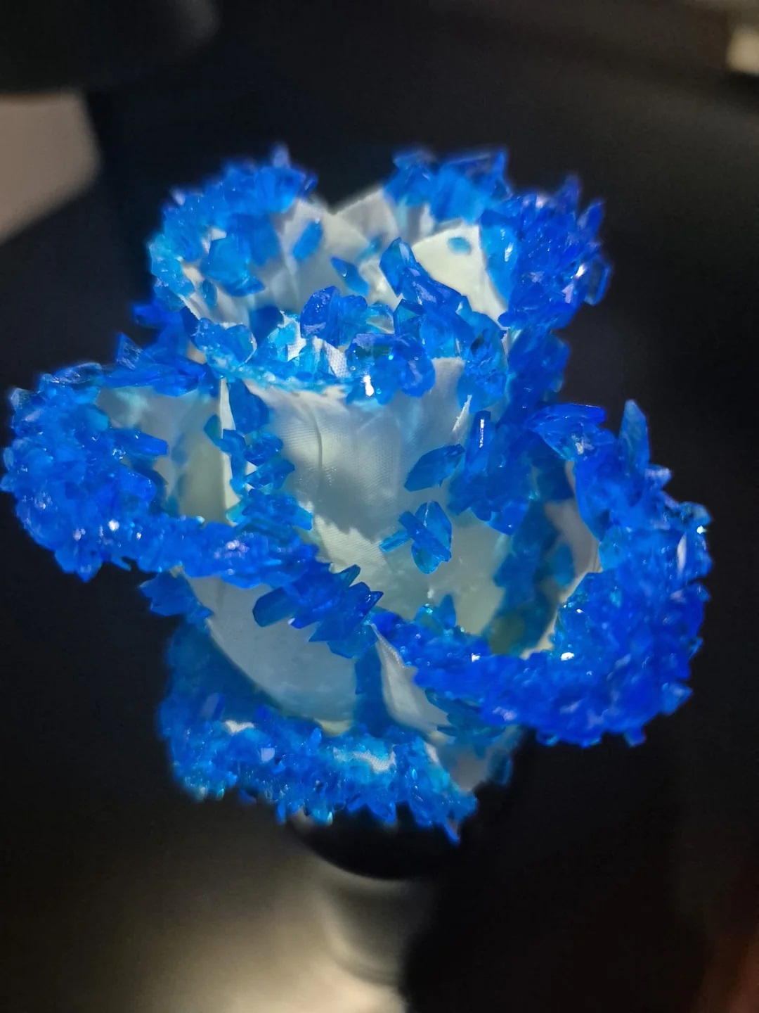

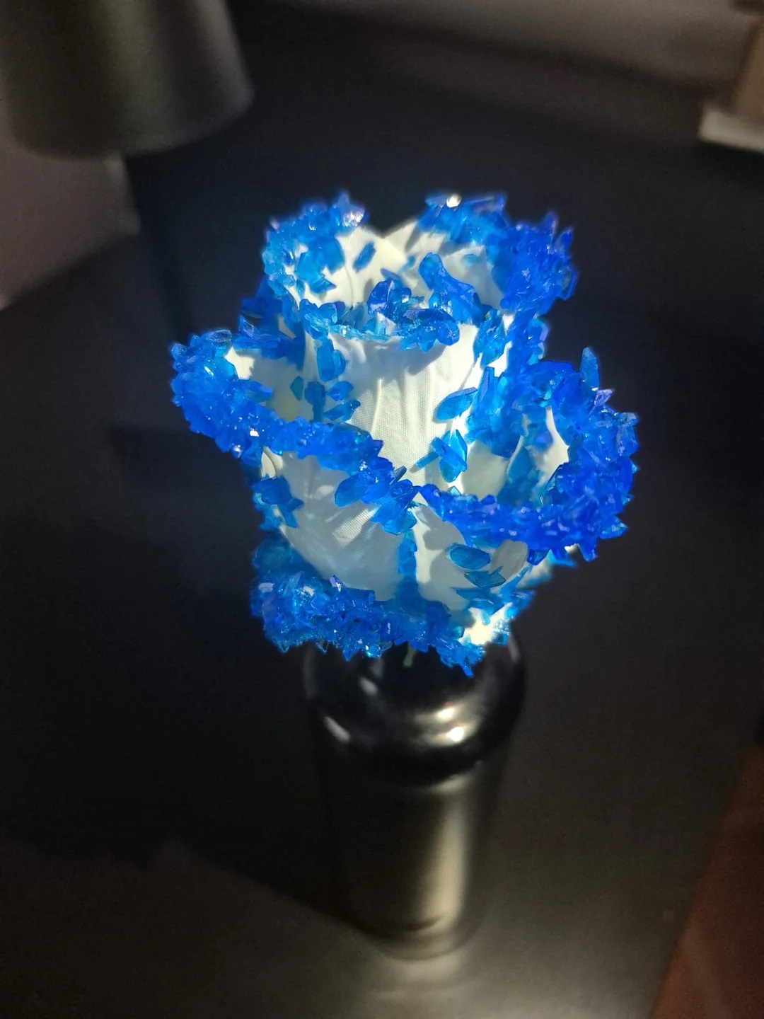

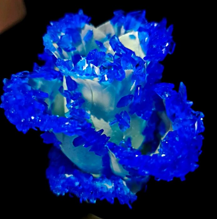

Цветок из ткани и раствор медного купороса:
Сначала пропитывают в растворе, вынимают, сушат, чтобы на ткани образовались затравки, потом погружают в насыщенный раствор для роста кристаллов на лепестках розы.
