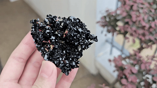

A cluster of copper acetate crystals I accidentally grew on a piece of scrap copper
a_cluster_of_copper_acetate_crystals.mp4 [7.56 MiB]
Downloaded 9 times
Get a bunch of scrap copper. Soak it in vinegar to produce copper acetate solution. Adding some dilute hydrogen peroxide speeds up the process. Takes 2-3 weeks. Heating will further speed up the rate of reaction, but it can be dangerous.
Once the solution a very dark shade of blue, filter and leave it to evaporate. Eventually you will notice small dark spots floating on the surface of the solution. These are tiny crystals and indicate that the solution is supersaturated. Just wait a few more weeks, and large crystals will grow, attached to the remaining copper sitting in the solution. This one took a few months.

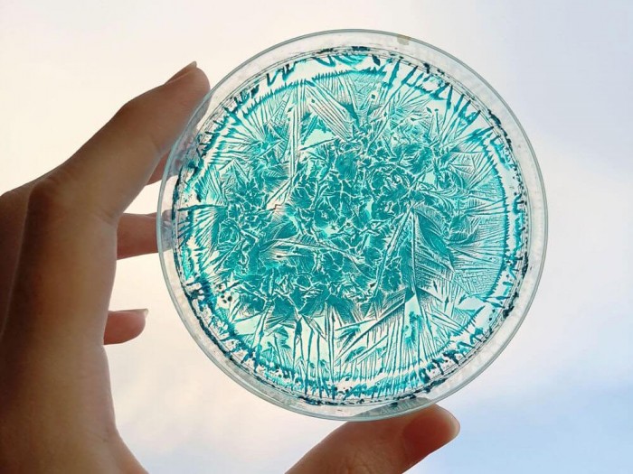

I left some copper acetate solution to evaporate in a dish. This is what it looked like after it dried
