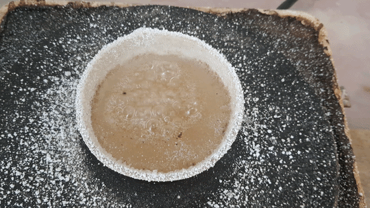

Calcium Chloride Dehydration - Part 2
http://chemistry-chemists.com/N2_2026/C ... .html#1002
