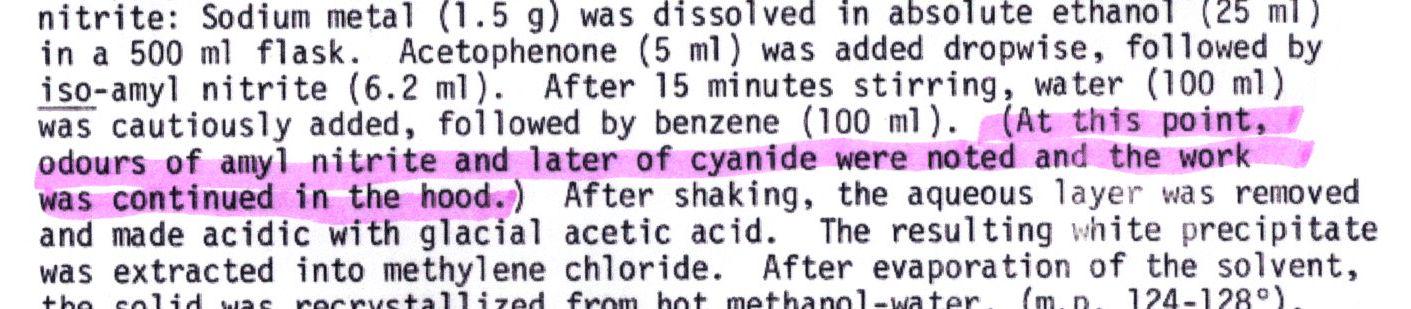

Seeing as how I'm often harping on safety in the lab, I thought I'd show a snippet from a paper I published in 1979, in the waning days of cowboy chemistry.
This was before the incident where I blew dinitrophenylhydrazine all over the inside of the same hood.
