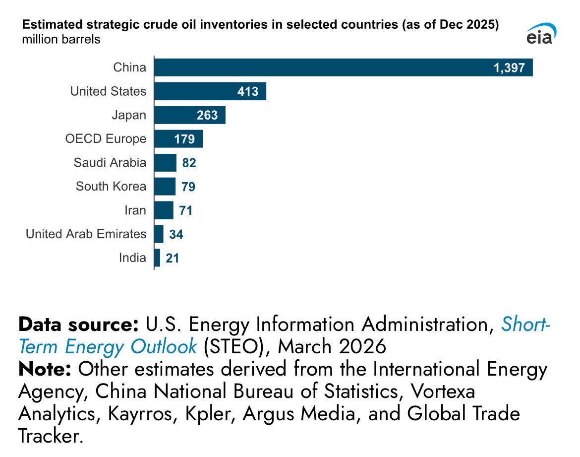

China has more strategic oil reserves saved up (for a war or crisis) than the rest of the world combined.
