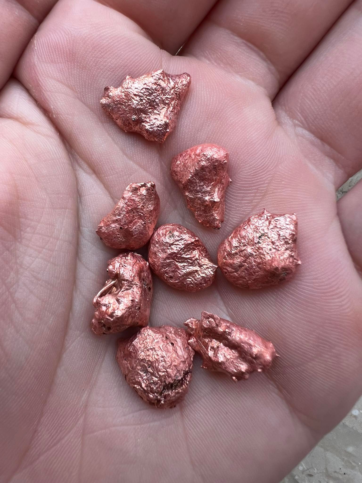

granules i made from wires with my torch, just for fun. have more but still in dilute nitric acid to remove oxide layer.
299448615_1115043666088921_4049329860081995450_n.jpg [ 445.2 KiB | Viewed 15045 times ]
