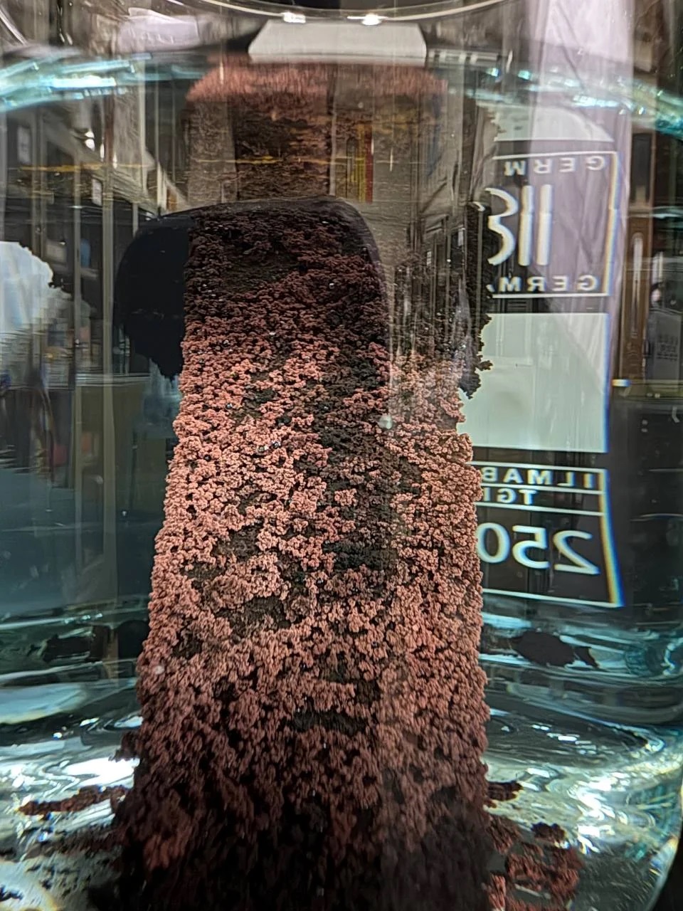

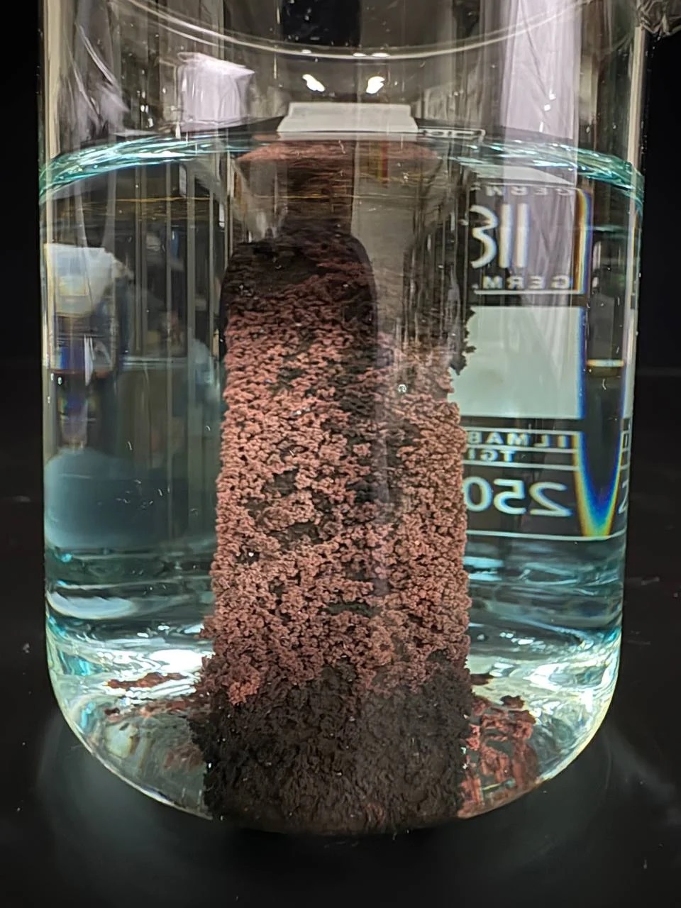

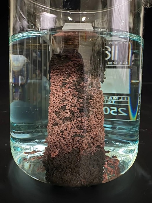

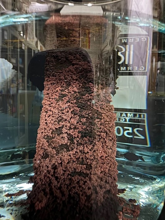

I've done the zinc + copper sulfate reaction quite a few times, but this is probably the best copper growth I've gotten from it after about 6 hours.
