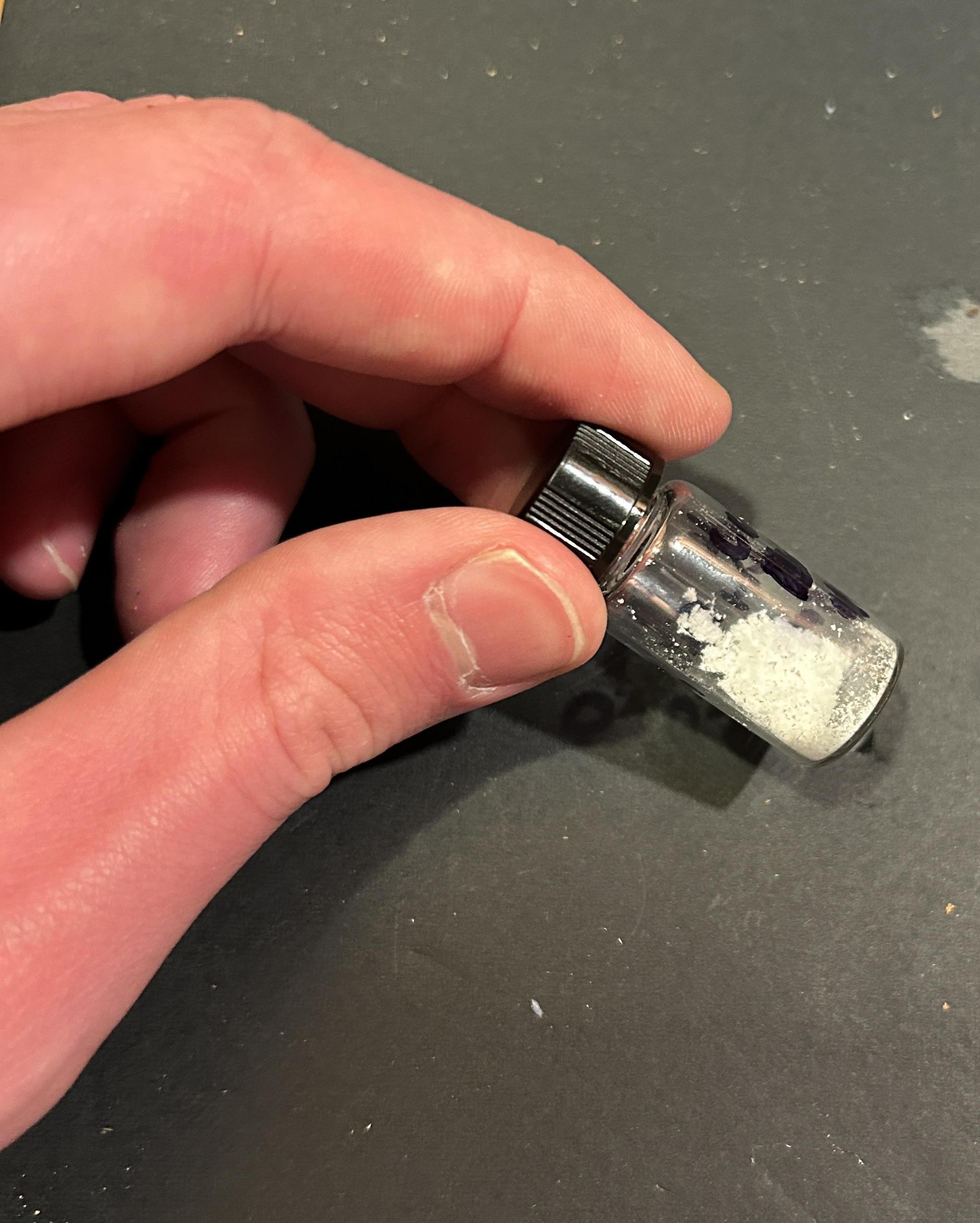

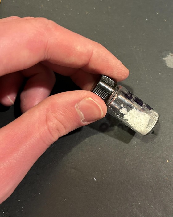

Some freshly prepared ammonium perrhenate

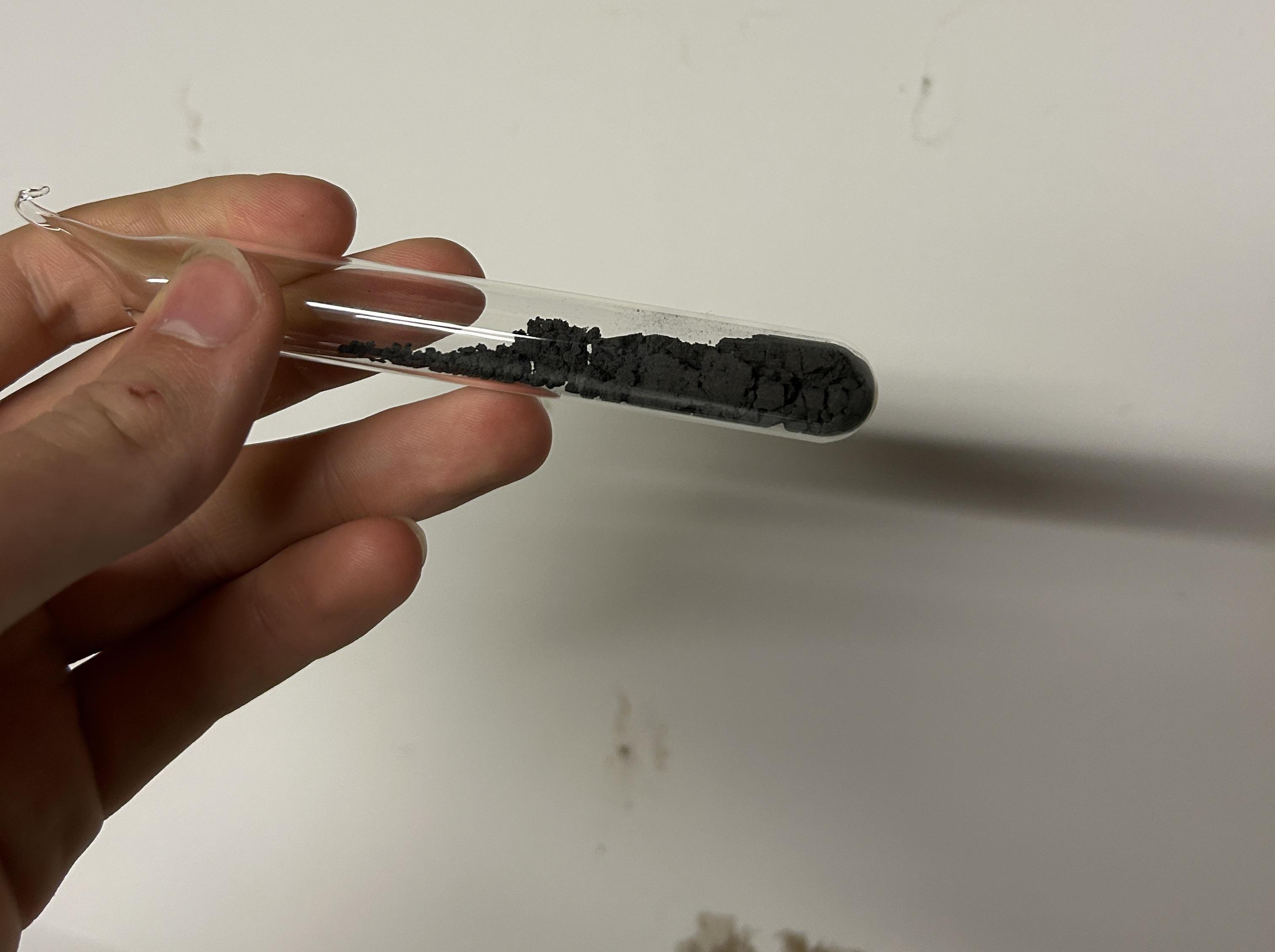

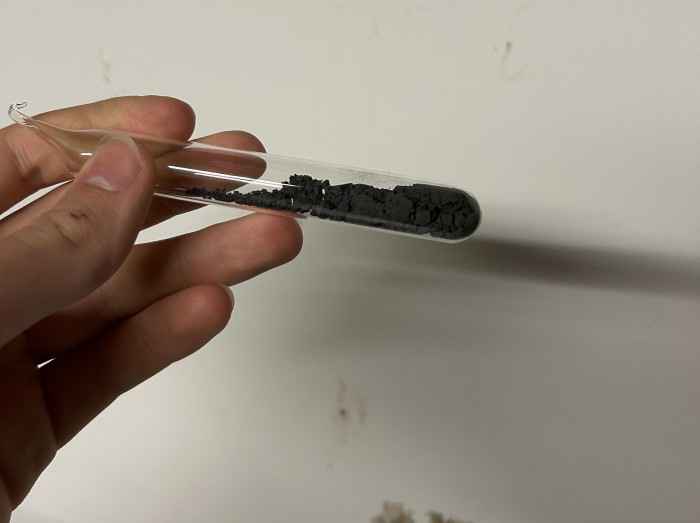

9.591g of ~99.95% Rhenium powder
