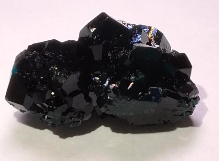

Posts: 66083

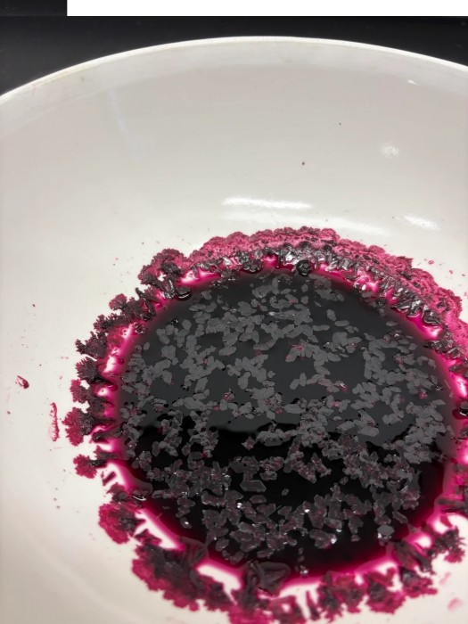

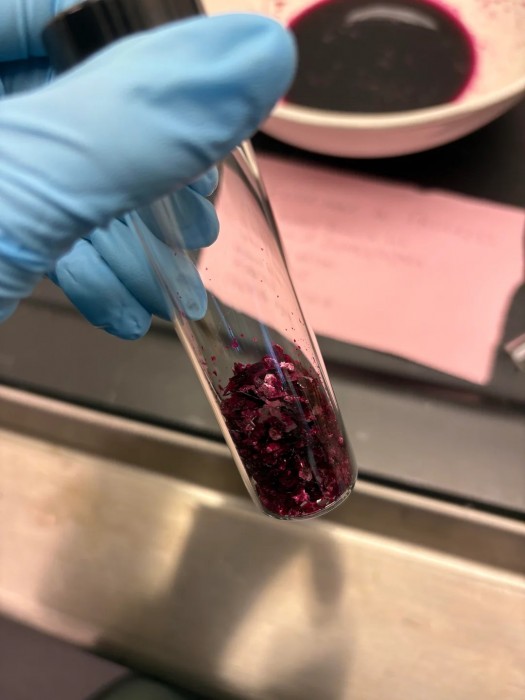

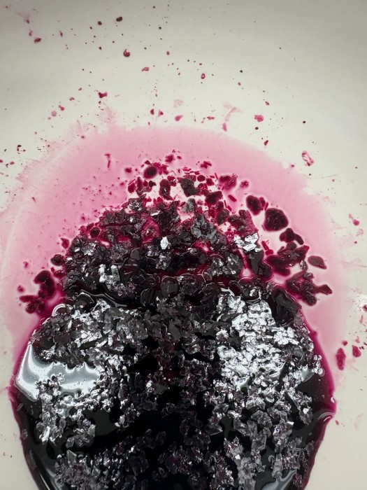

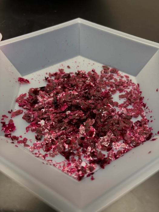

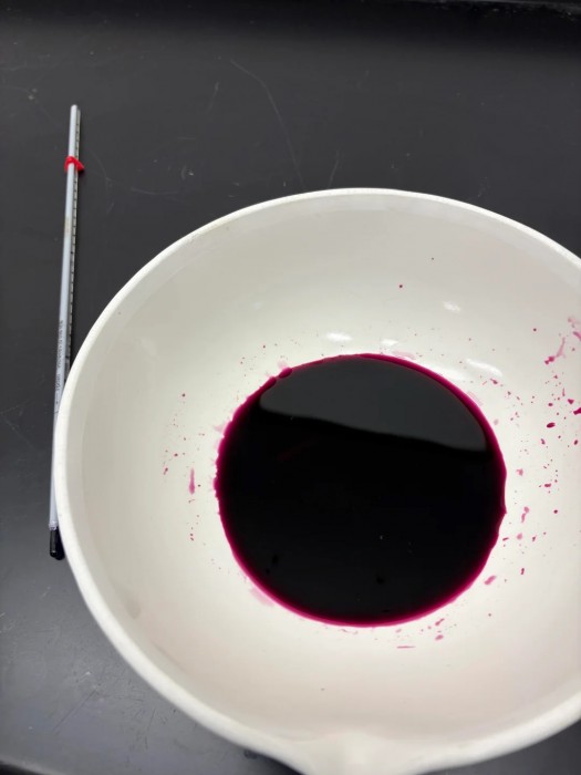

[Co(NH3)4CO3]NO3 - relatively easy synthesis, with a beautiful result! These formed after 1 day in the evap dish. After filtering, I realized there were even more (micro crystals) in the Büchner funnel flask! So we shall see tomorrow if we get even more!
