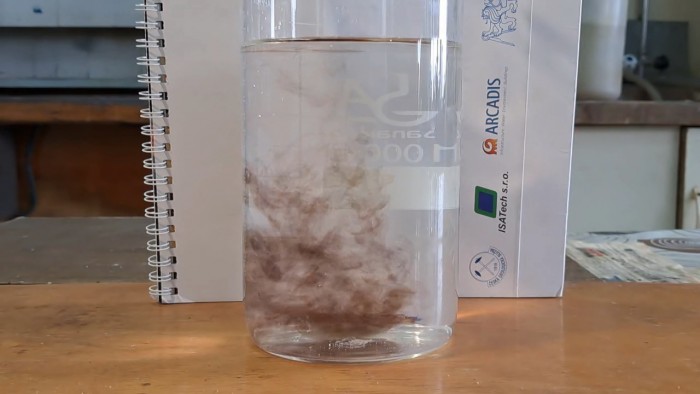

Experiments with Magnetite (Fe3O4)
Iron Oxide Pigment and Hydrochloric Acid - Part 1
http://chemistry-chemists.com/N2_2025/C ... -P4-1.html

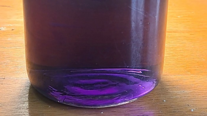

Phenol, Iron(III) Chloride, and Distilled Water - Part 3
http://chemistry-chemists.com/N3_2025/C ... .html#1003
