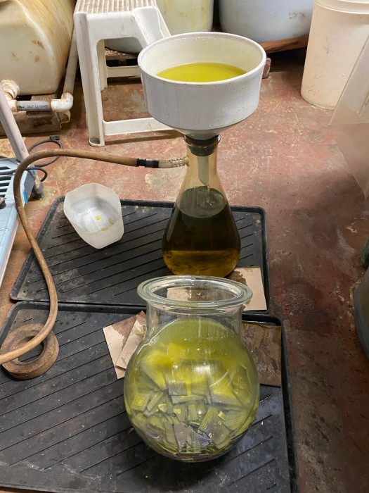

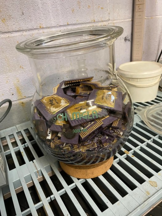

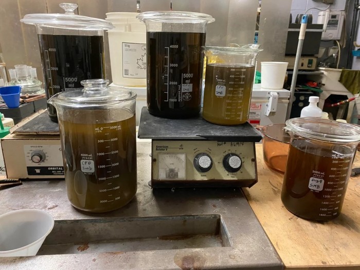

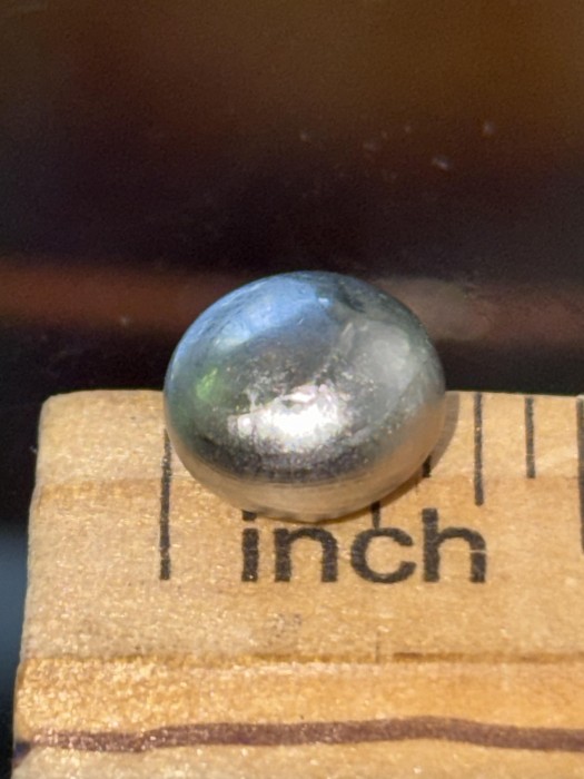

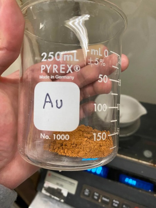

Gold extracted from Stone Age CPUs with Aqua Regia - end results
A clip that shows nitric acid stripping away the metals in a vessel
This was a gig i picked up fresh off community college around 2015, working at a garage lab built by a retired chemist who is E-waste recycling hobbyist.
the whole process is designed to be vacuum sealed and all wastes are transferred into a giant plastic container which are then neutralized with NaOH at the end into an environmentally safe pH. Those containers will have a good chunk of copper in them and they were sold off to other copper recycling companies that have the means to handle them (basically free waste removal and get paid for the waste as well). So no waste goes into the environment or the sewage
the place was filled with equipments from the 80s. While many may consider the whole setup looks primitive, over there I learnt more about inorganic chemistry in one year than what I learnt in school for 3 years
due to the fact that i was not in a corporate environment, i was not supervised and the owner was very hand off so he just handed me the key to the whole lab, so i would just show up and not put on any PPE on and start doing cowboy chemistry. Anyway I rly don't recommend anyone handling strong acids without PPE. thinking back, i thank God for the fact that nothing serious happened. I was a dumb young kid and definitely very passionate about chemistry

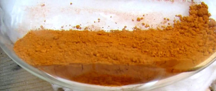

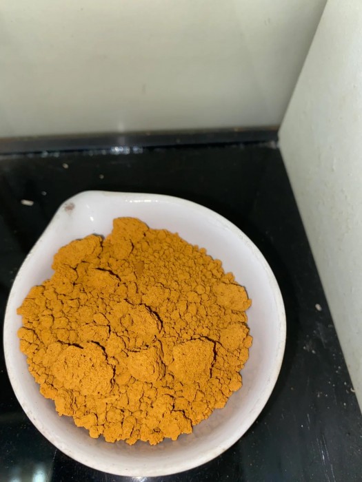

PostPosted: 14 Jun 2025 21:08
Posts: 65868
Золото, осажденное из царской водки
